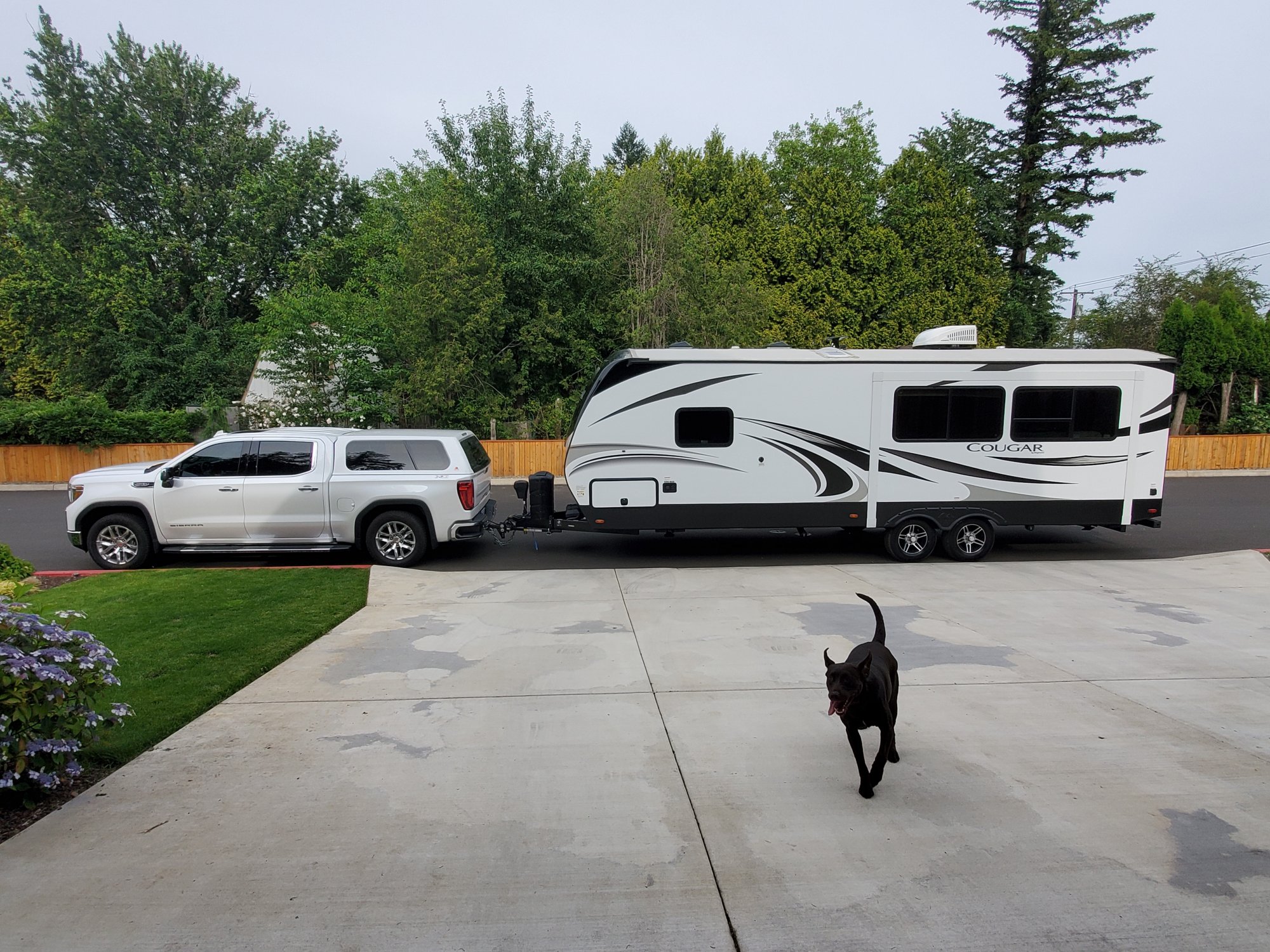

2 hours ago, oldmann said:
With a travel trailer of that size the back of the truck is going to go down.  Have you tried adjusting the hitch to the next position?  Do you have a hitch with the correct amount of drop?  Do you have enough tongue weight?  Does your hitch have an anti-sway device?Don't try to maintain the unloaded height of the truck. Down two or three inches is where you want it.
This is how she sit.
I guess you could bag it, but looks about right to me.  Front and rear gap above the tire is really close to equal.
Edited by oldmann
