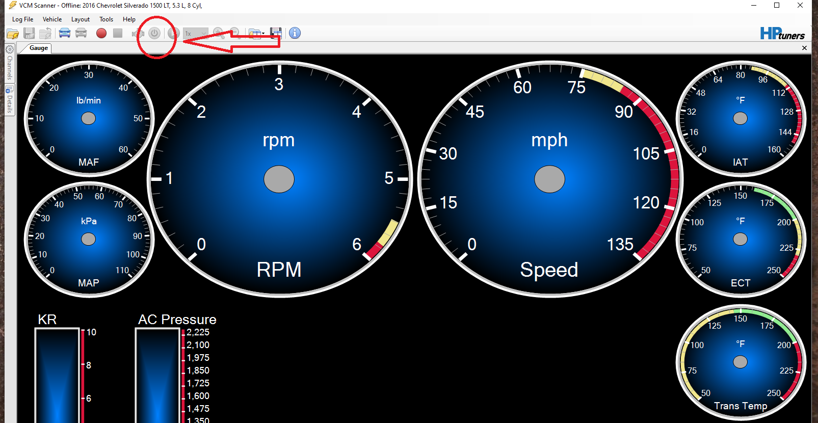

Wouldn't the VCM control reset do the same for the trans re-learn?

VCM controls are part of HP Tuners Scanner app. If you have HPT, you have it.
45 minutes ago, flyingfool said:
problem is i have the older cable style HPT, not the newer bluetooth model
So do I. First gen MPVI. Plug it in and open the scanner. Look for the vehicle controls and options button. Get the latest release here: https://www.hptuners.com/downloads/
