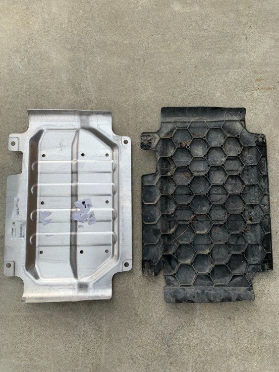

For my Silverado I bought a metal OEM one from the dealer (I went to the lot, found a truck with a metal one, pulled the VIN and asked for a new skid plate "shield")
PN: 23385004
I believe that it was $50. well worth it since my plastic one cracked in a few places. $46 at GMpartsdirect
  • Thanks 1
That's only the bottom one and not the front piece. My Trail Boss already has the bottom metal piece. I don't know of any trucks having the front piece from the bumper to the cross member that is metal. The one I posted above is the only one I've found that will work with the stock suspension and bumper. All the other ones are for an aftermarket bumper or only work with a specific lift kit.
