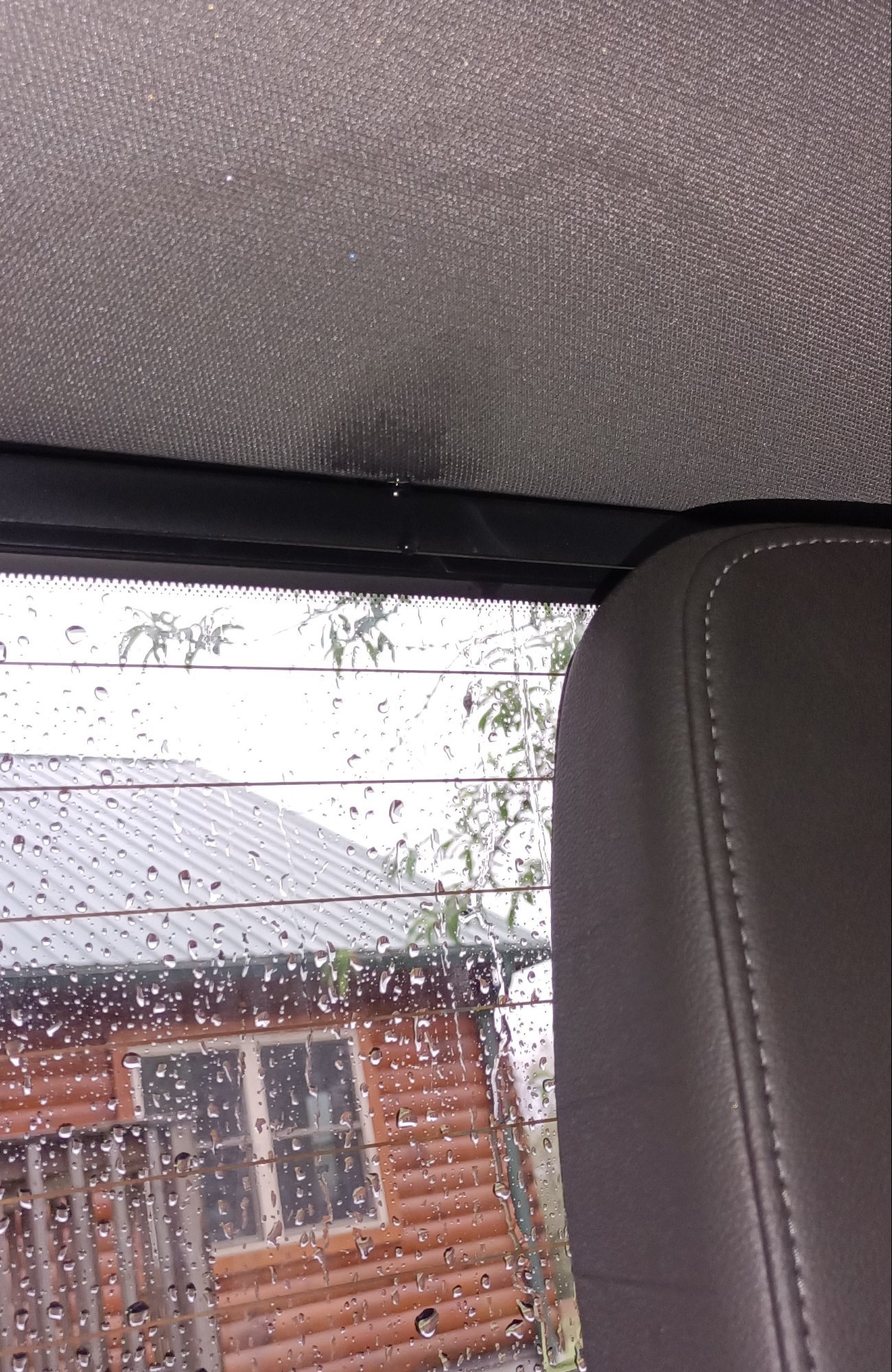

Add my 2019 sierra. It's dripping water from headliner over rear window. Nice water spot on a 54000 dollar vehicle. Only 34000 miles on it alas 4 years old. S O B.

2 hours ago, shadow gray 2020 hd said:
Back to the dealer mine will go.  Confirmed it is leaking yesterday.  Leaking from above the rear window. About the same spot on both sides.
Where do you think it’s coming in at? Do you have the five clearance lights on the roof? Wonder if it’s from there?

Has to be from the rear spoiler bolts.  The leaks are not around the actual window.

The tsb associated with the leaking rear window says the headliner has to come out and they remove and reseal the window.  I don't know though, because the leaks in my case look to be from about 3-4 inches above the window.  My headliner is discolored, not sure what they will do about that, if it stays that way due to being stained.
The girl I talked with at the dealer to make an appointment was clueless.  She said she didn't know anything about a tsb for the leak.  They have me down to look at it next Friday.  Still raining here, and my truck doesn't fit in the garage.   Hopefully don't get water in the floorboards/carpet, sure don't need mold in a truck that cost this much.
