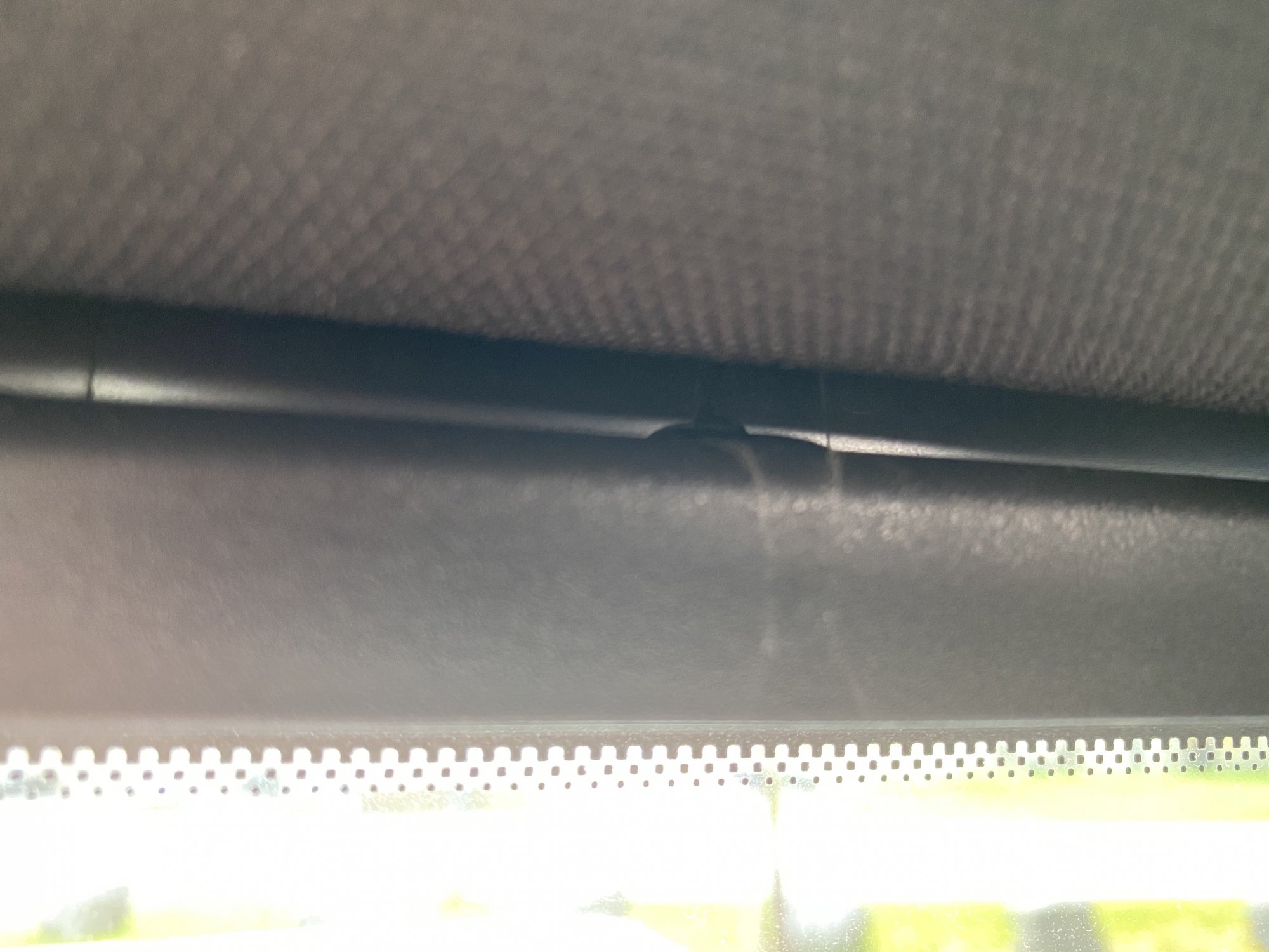

I just got mine back from the dealer but once i got home, i saw the headliner was damaged with a trim tool on both sides. The headliner is also loose and just resting on the window track. The headliner clips are broken. Taking it back to the dealer in the morning...aba31cce86751a55f45c922a20709c8a.jpg6c8ce7325acf9e5c813263592651b1a2.jpg

My dealer tried a few times and it kept leaking. Since then, I've sealed it twice with good results. I'm certain over time the flexing of the truck and shrinking of the sealant may cause some intrusion. There are some who have use pieces of Trim-Lok at the top of the spoiler and also between the bottom of the spoiler and top of the window. I may try that myself in the future. It's obvious that GM is not concerned with repairing or redesigning these windows. They figure they just have to "try" for 36,000 miles and then it's not their problem...officially.
I have thought about going to an independent glass company and have it replaced with aftermarket, be it slider or fixed glass.
