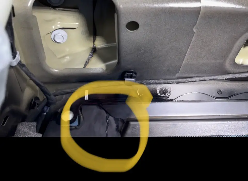

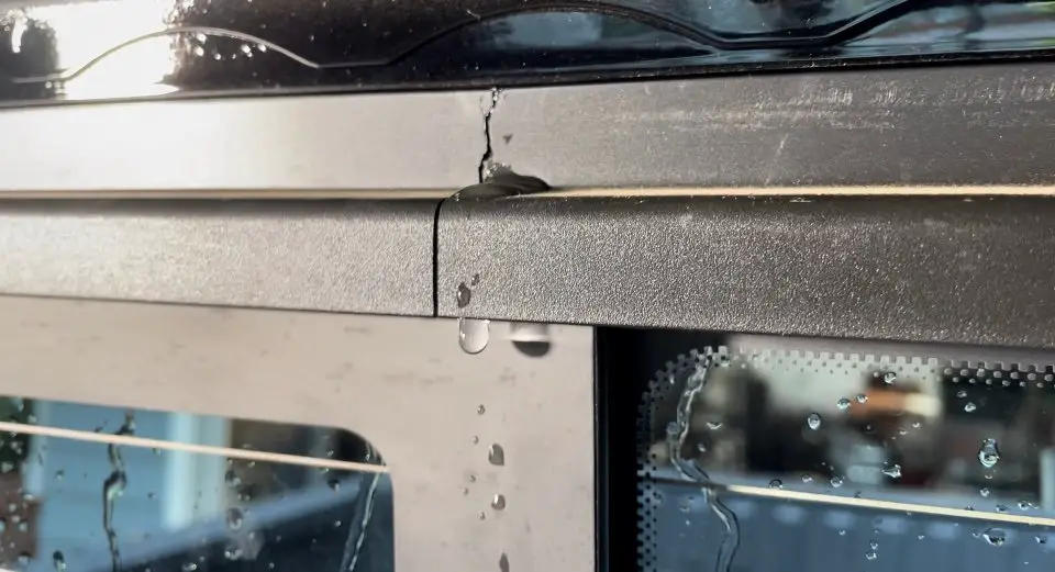

Some talk here about whether this is from the window or scoop bolts. Pretty sure scoop bolts are fine for most of us - although the 15 or so bolts on the top of the cab needs to just go away in the next body/build/version, if only for piece of mind.  I don't know who thought a scoop and 15 holes on a cab would be a good idea - but amazingly they seem NOT to be the issue (at least for me).
Videos were too large to attach, but you can see what I found in a couple pics below - all bolts dry, window leaking in streams from the sides, cracks, etc. you take the trim and headline off, more easily seen how the outer portions of the window tag the headliner, somewhat makes it look like the leaks are above the window.  Maybe some do have those scoop bolts leaking but mine came from 4 separate spots. Two are pictured below.
Solid back window coming this week, through glass specialty shop.  No dealership from me, too many times I've come back to pick up my truck with ten other things broken and needing repair.  Learned my lesson there.

yep, most leaks come from the actual frame cracking, not the bolts. I don't understand why they use a plastic frame. Using a metal frame would eliminate this. I can't see how all these warranty claims are cheaper than switching material🤦🏼
