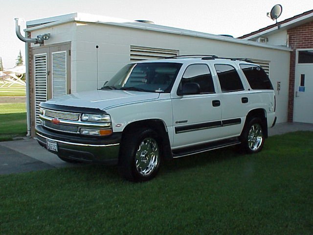

Look at the picture of my truck, eyeball a line between the outside of the grill and the inside of the headlights, straight down to the bottom of the chrome bumper.  The wire is connected on the chassis behind the bumper.
