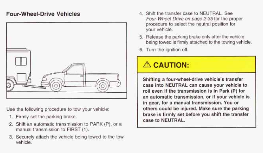

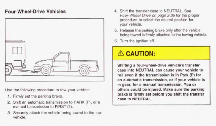

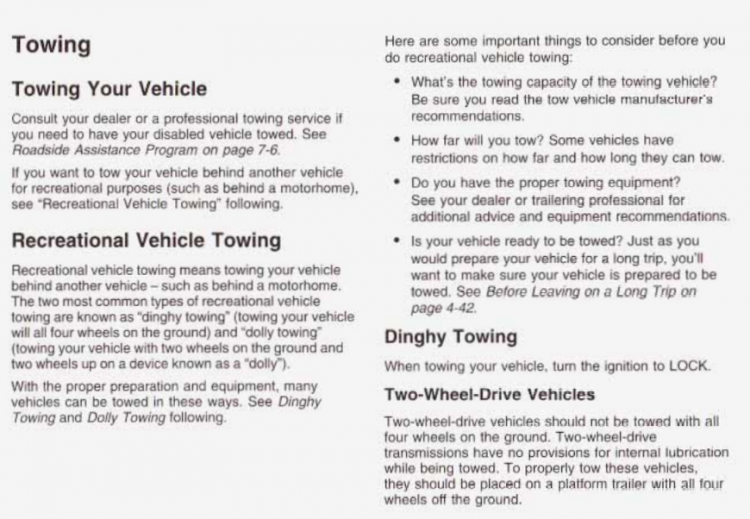

isn't that the reason for having neutral setting for the transfer case? I still have my manual for my 2003 which should be the same as yours and there's a section in there specifically about dinghy towing with all four wheels on the ground. It says you can if you put the transfer case in neutral. Even has a picture of a car being flat towed behind an RV.
