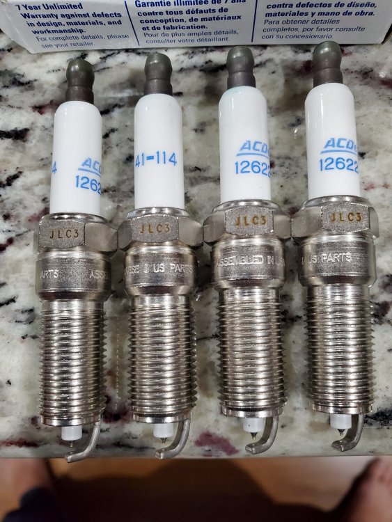

I have read on here that there are fake AC Delco plugs out there. I want to know how I can tell if they are fakes. I have included two pictures of the plugs I bought so that we can hopefully educate me on what are fake and what are real AC Delco spark plugs. I ordered these from Amazon.

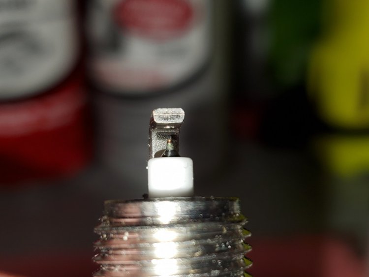

It won't let me know post the picture of the box. This is a picture of the tip of one plug. To me they look legit.
Another shot of the electrode and ground strap.

Based on comments made in the video, you can see that in the packaging all the print is nice and clear and the colors are within their own boundaries. Specifically the red is where it is supposed to be on all boxes.
My plugs have all the ground straps in alignment with each other when looking at the laser etching.
My other box of plugs have a different code on them. But the straps all align and the print on the boxes is correct. If you look closely you can see the iridium pucks on the ground straps and on the tip of the electrode. I haven't checked the gaps yet but I feel like they will be correct.

Extremely large differences in price should make you suspicious.  Keep in mind that you get what you pay for; materials that lead to long product life may not be included in counterfeit parts (such as no iridium on iridium spark plugs).

I bought the ones pictured at Rockauto. I feel pretty confident they are legit. However, it was said, that you can feel pretty darn confident that the plugs that come from the dealer or one of the local big box parts places are also legit.
