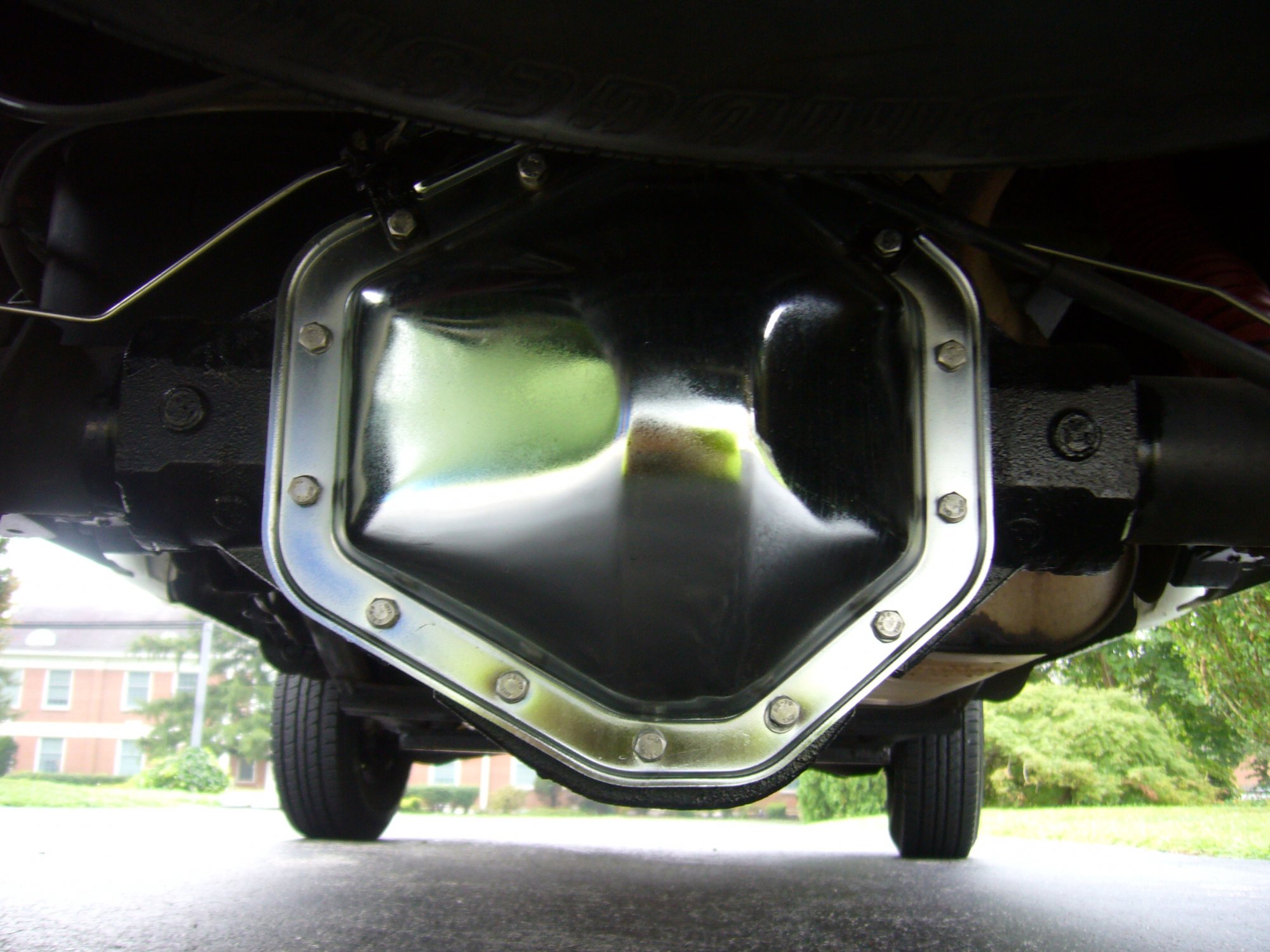

    • I changed the factory fill oil in the rear diff of my truck for the first time today and the miles is close to 9000 on the truck. There was a lot of fines on the magnet, a very thick layer but working it through my fingers it all felt like mush and as most know it appears like graphite, so no surprise chunks anyway. Certainly was time to do it from my thinking and could have been done sooner but the oil didn't look awful but sure wasn't new looking and never expected it to either. I did use some solvent to help me clean out the bottom area of the axle housing, just get any other stuff settled at the bottom washed and wiped out of the housing for the bit of effort it takes. I used Amsoil Severe Gear 75W90 in the easy packs to try out what they are like and I used up 4 packs and didn't spill much at all in the process but did take all four of the packs and go to the work bench and emptied them into a measuring container and there certainly was some in them that added up to something, then poured that into one of the easy packs and squirted in what I could get out of it. I would say the level is within 1/8th of an inch of being level with the threads at the fill plug so just the perfect amount. Once again, more than what GM says the fill volume is but computes with what others are adding to their rear diffs as well.
