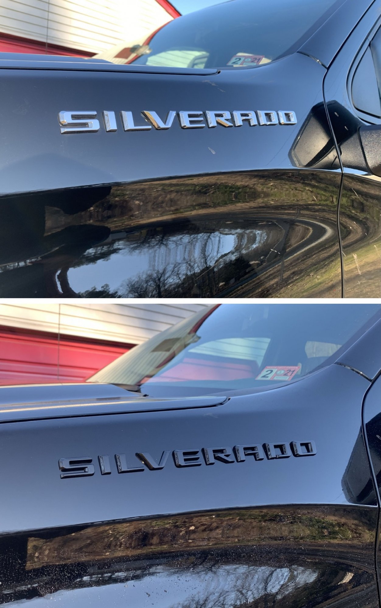

black 2019 Rocky Ridge Silverado RST, and it bugs the crap out of me.  I just rebadged all the emblems except the Rocky Ridge one on the tailgate.  I know a guy who paints for a GMC dealership and he is a really good painter, might see if he could do the buttons along with the badge.  I also thought possibly covering them
