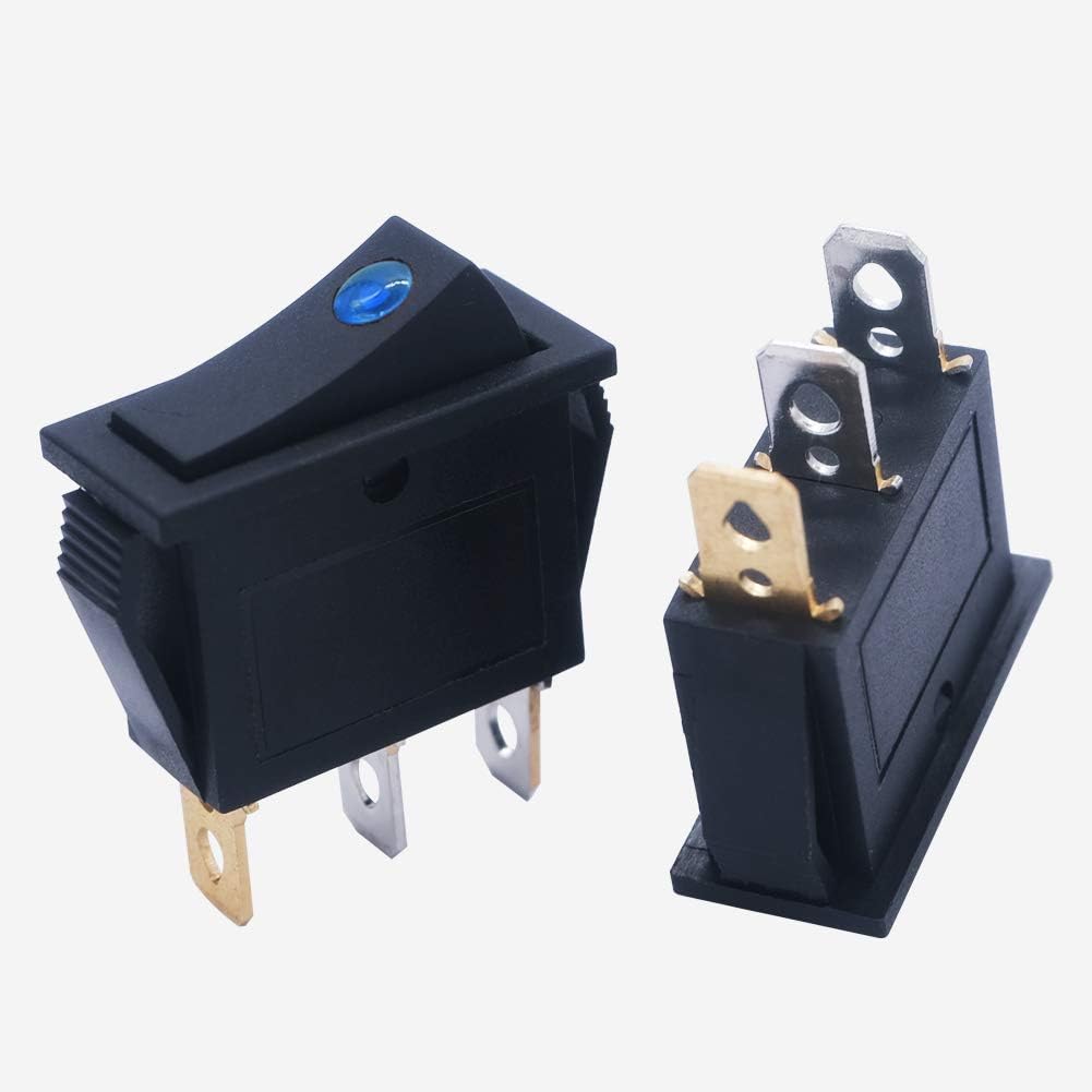

Thay harness should be ok with your lights. The problem with the wire under the dash is this harness, like most, is prewired for the switch to be switching 12v to the relay with the ground side of the relay being permanetly attached. The wire under the dash is a relay control wire which gets ground when the highs are on. You can use this harness, but you will have to rewire it. Honestly though if you are not familiar with wiring and hooking up relays im not sure i'd recommend you to try to do this yourself. I certainly dont mean to offend or anything, but wiring can be a fire danger if its not done right. Safety first! It's not that hard to do, but things can get a little complicated...
If you want to use this harness it would be easiest to connect it to the bigh beam fuse under the hood and just run the 2 wires through the firewall. In which case in the diagram below connect the small grey wire coming off the switch to the high beam with an add a fuse instead of to the battery like it shows. The small gray wire and the small blue wire need to go through the firewall. Thats the only difference. The big red wire still connects to the battery (or other suitable connection point, there are a few good candidates)
if you really want to connect it to the bcm wire then you need to rewire the harness. Relay coils are bidirectional. As long as there arent any unwanted internal connections in the harness...
The switch is wired for a constant ground (for the led indicator) and a constant 12v, when you flip the switch the output wire gets 12v. You should be able to rewire the switch so the output is ground when the switch is on. Simplest way is to swap the 12v and gnd wires where they connect to the switch. Issue is if the switch light is an led the switch would work, but the built in light may not.
If you do that and the switch then puts gnd on the blue wire when on just connect the other side of the relay coil to 12v instead of ground. In the diagram above that means the large grey wire from the relay, connect that to the red wire after the fuse. Just connect it right there at the relay itself. Next problem, the diagram doesnt make it clear, but i would bet the ground wire of the output on the far right is connected to the ground going into the relay.  You will need to cut that wire and connect it to ground separately. Or dont use that wire at all and ground your lights independently. But remember the relay side of it may have 12v on it at this point, so you must be careful to secure it where it cannot short on anything. It's honestly pretty simple, but hard to explain...

Awesome thats what I am going to do - I have 4 light bars and cant seem to find any harness with 4 leads so Ill likely just get two harness, wire them up that way with two switches and run two wires off the fuse into the cabin - what gauage should I run from the fuse? Any harm in running two wires off of one fuse tap?
Just run a tap like this directly into the switch, would I still be able use the illumination part or is that what you're saying would need some re wiring of the harness?
that should work fine! you shouldn't have any issues with the switch working, the harness was setup for it being a positive side switch and if you're running off the high beams fuse that's exactly what you have. the only difference is your power is on only when the high beams are on instead of all the time. as a bonus the light in your switch would also light up only when your light bars are actually on, so you can leave the switch in the on position 24/7 if you want to. it won't light up or drain the battery, but when the high beams come on if the switch is on the indicator will light up then.
the wire that comes off the high beam circuit only runs the light in the switch and the relay, very low current. to be safe you should run a wire that is capable of handling more current than whatever your fuse is rated for. 5A is about the smallest you can find easily. they do make 3A fuses in that size I'm pretty sure but you may have to search to find one, I'd run anything from 22awg to 18awg. I usually use 20 or 18 personally for almost everything that's low current, even if you could technically use something much smaller. its just easier to work with wire that isn't so tiny.
your lights combined should draw around 20A and it looks like the harness you are looking at should handle that just fine. if you're comfortable doing so you can splice the output wires and run all 4 lights off one harness, or  get 2 harnesses, there should be no problem with that at all. also gives you the flexibility to have your off road lights on 2 different stages, you can have 2 on, or all 4.
if you do that you could run just one wire from the fuse into the cabin, then split it and connect it to both switches, there's plenty of capacity in a 20awg to run 2 switches and 2 relay coils. that would save you some wire!
