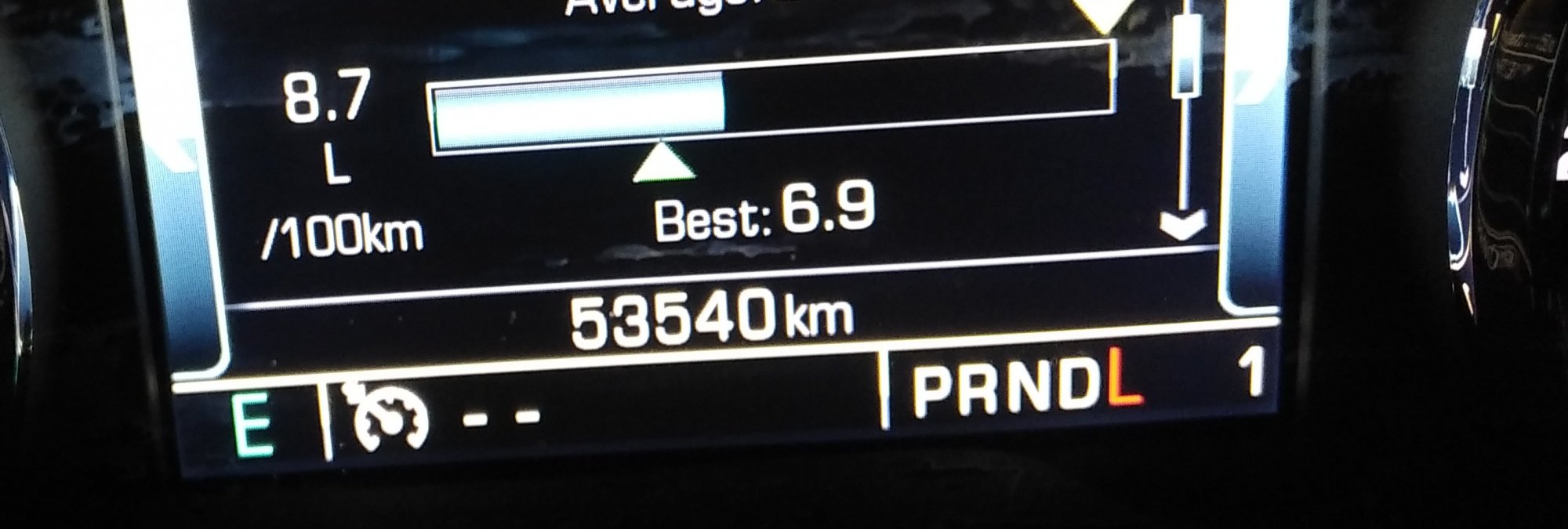

Hi, have only had my 2021Duramax HC for couple of days but with the current cold spell of -50C in Manitoba I have had no issues with cold start. Forgot to plug it in 3 nights ago but it started next day without any issue (sleeps in unheated garage). I am very concerned about fuel consumption though. My 2017 Duramax LTZ was amazing at anything form 6.9l/100km (wife driving) to 8.7l/100km (my own heavier foot!) on highway trips. Around town it was an average of 11-14l/100km depending on how much warm-up idling I did. I am considering returning the 2021 to the dealer and taking back my 2017. As you can see on attached pic of 22 Jan 2021, these were real life numbers on my 2017 while using the "50km distance average" setting .198759240_IMG_20210122_07124232.thumb.jpg.1f7079bb5f06cce46699930f36209b3f.jpg. The new features in the HC are not worth sacrificing a perfectly good 2017 with only 54k on the clock and zero problems.

The consumption shown on the pic is from my 2017 LP5 that was traded. The HC LP5 I'm driving now only gives me 28 - 32l/100km on highway. And this was on a "special" highway run to see what I could get with just me and the wife, no cargo and feather-footing the pedal. I became so frustrated I abandoned the exercise after a while and just went home and parked it. In town consumtion is anything from 34l/100km to "off the charts". Not impressed but this is another topic not related to your original question - my answer which I hope shed some light on your question. And on that topic, I do find the 2021 taking longer to warm up the heater to make the cab comfortable. On a trip less than 13 minutes it barely heats up the cabin (again this is during the cold spell of -50C). That being said, the 2017 was faster at heating the cab in cold weather.
