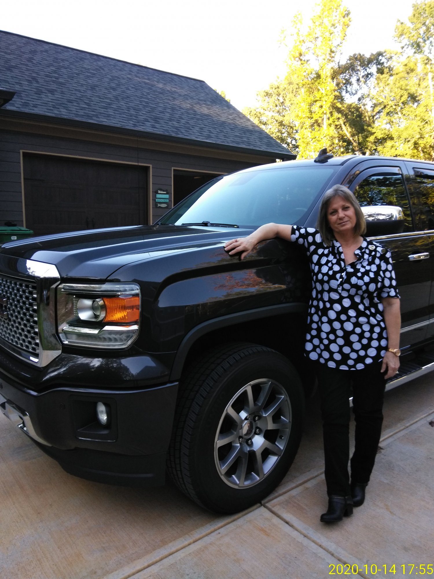

   2 - times when I came to a stop it went dead.   1- time it went dead with lane departure showing.   Every time when I crank it back up the voltage goes way up for a minute.
   Power steering hanging up when turning.
   3- times a very load bump noise coming from the passenger side dash or under hood.
   The moon roof will not open sometimes but clicks.  Then when it does open it wont close.  When these problems happen it works after a while.
   All these problems have taken place within the month.  My truck has 66,000 miles on it.IMG_20201014_175553.thumb.jpg.4780652871636fcbe849b27b2d1b9f83.jpg
