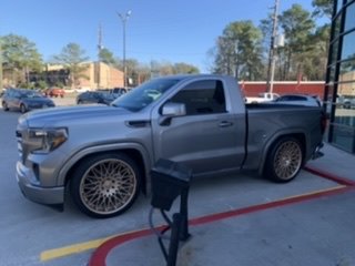

Starting this thread to document the build on my 2020 Sierra. As I live downtown I want a vehicle that’s small and easy to get around in and something fast to play with.
GM doesn’t make a single cab short bed and definitely doesn’t make one with the 6.2 so I’m having one built.
Starting out with a 2020 Sierra 2 door long bed (8’). Going to chop the frame down and install a short bed (5’8”) on it.
Moving forward after that we are looking to put a supercharged 6.2l bored out to 416ci.
Started off with the easy stuff like tinted windows and new stereo (new door and tweeter speakers, amps and 2-12” subs). Now it’s at the body shop for the short bed conversion. Then to suspension for a 4/6 drop. A brief stop for some Katzkin leather seats. Then to the performance/speed shop for the engine work. Then off to have the trans built to handle the aprox 850hp the engine will put out (@ the crank).

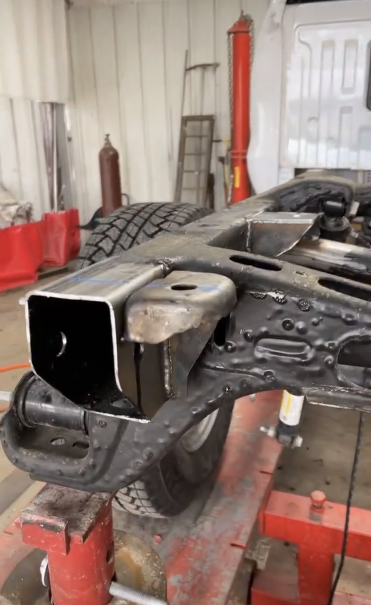

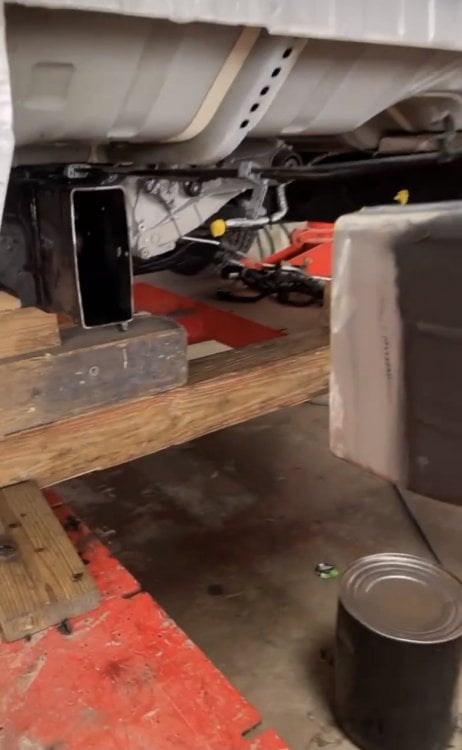

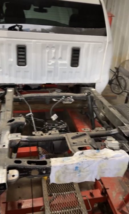

Just started the fun part of the build process at the body shop.
Here they are cutting down the frame.

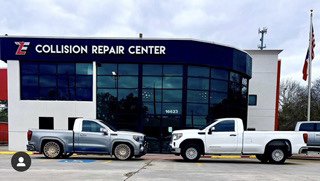

The body shop doing short bed conversion is Leading Edge Collision in Houston. You can follow the body shops part of the build on Adan, the shops owner’s, Instagram. @Adanomyte. https://www.instagram.com/adanomyte/?hl=en

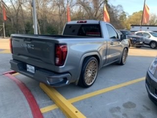

Have my (bought new) 2007 NBS SWB RC still.  This is after selling a RC step side 1990 Sierra GT.   Wish GMC would make one again...with AWD and Forced induction 6.2.... Call it the Hurricane  (larger than Syclone). Would buy one in a heartbeat. Until then I enjoy watching these amazing builds. Here is one that was also cool.
Edited by EXSlider400
That is Adan’s truck, the owner of the shop that is doing mine.  You can see more of it on Instagram, @Adanomyte.
