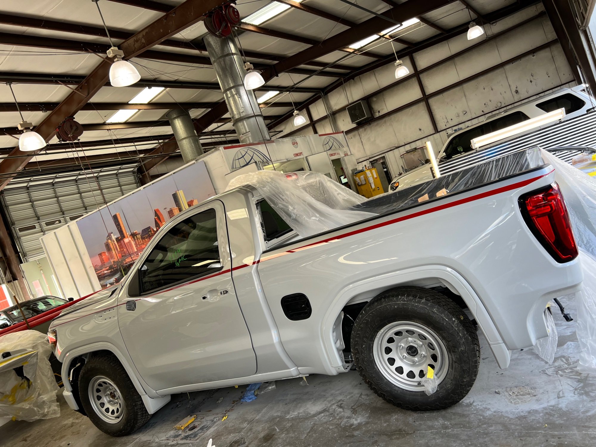

Man this project is taking longer than expected. There’s a light at the end of the tunnel though. The truck is almost out of the shop that is doing the short bed conversion and custom paint.
The one off wheels are in.
The engine is finally done!!!!
Still moving slower than I expected but it’s progressing.
Edited by Descartian
