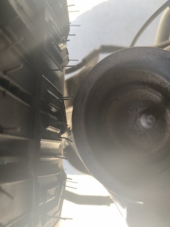

Hi, brand new to the forum here. I got my 2019 Trail Boss earlier this month and have been absolutely loving it, been doing a bunch of mods to make it sort of my own. I put new tires (Falken Wildpeak At3w 295/70r18) and they rub a tiny bit but its not that big of a deal. At this point, the last thing on my list for this truck is to level it out, but I'm reading that the ReadyLift UCAs (their 1.75" kit) rub against 295/70r18 on stock wheels. I don't have the $ to buy new wheels with a more negative offset, so I was wondering if anyone here has had (and fixed) this issue. Theoretically if I just ran small spacers I should be able to clear the UCAs no problem right?

Ok, thanks. I think I understand what you're saying. So the ReadyLift kit should be fine with my tires as long as I run a slight spacer to clear the new UCAs?
You can run spacers to solve the problem - pending how much space you need.
Careful with the spacers... unless you go over 2" you will beed to cut your studs.   Don't forget this step!
I just put a set on mine. Yokohama geolander x-at 295/70/18. Also have the RL level kit with new UCAs. They fit but it’s tight. No rubbing against the UCA. Not sure about rubbing the mud flaps I had already removed those.

Awesome. Will likely order the kit soon. Worst case I have to go over to autozone and get a 1/4" spacer.
I’m running a 1-1/2” spacer and I got good clearance of the UCA. Stance looks 100% better and I’m still on stock TB DuraTracs for now.
