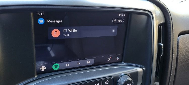

Can you open your SMS app on the truck's screen in AA? Does it show the new message? (it only shows messages that were received while connected for that drive)
I am not sure what version of AA is available on the S10, but on my s21 it is 6.2.610914

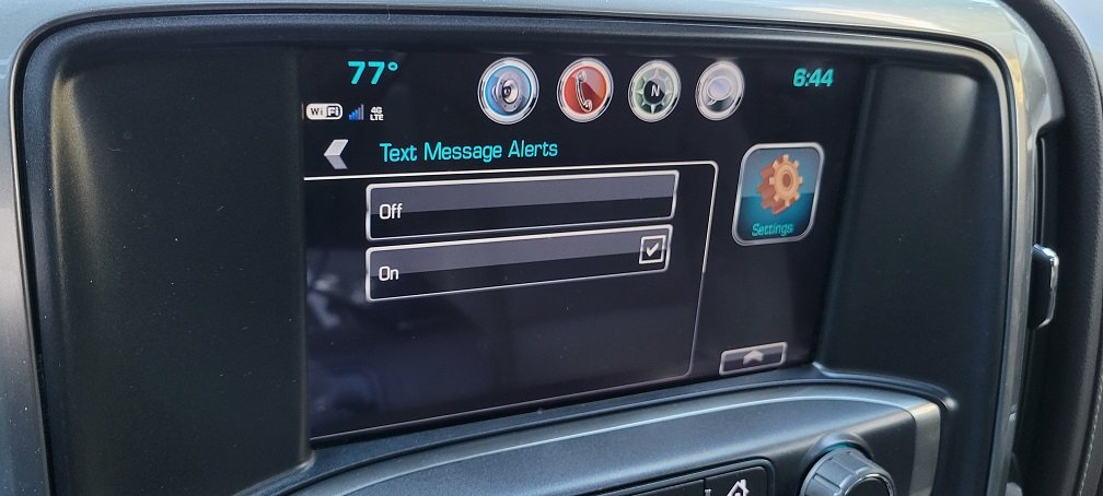

my settings look like below, and I get a truck (Chevy MyLink) sound effect when a message arrives (like the door chime), unless I turn off the setting the Truck's/MyLink setting (see top photo)
No matter how I configure the AA settings, I get a toast pop-down on the screen, but the sound setting seems to work but is worded backwards in my opinion (turn this on to turn sound off)
 Truck's MyLink settings under Bluetooth:
