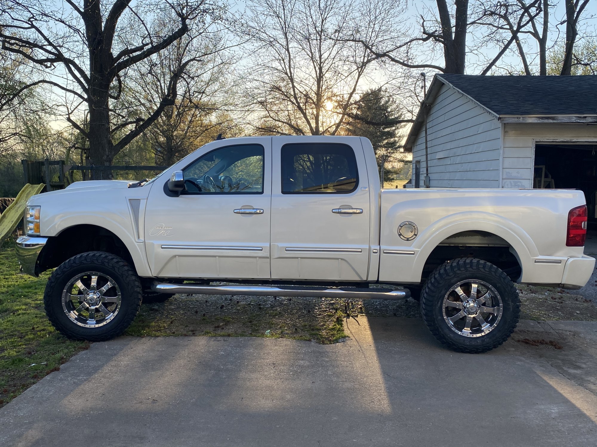

I have a 2012 Chevy Silverado 1500 with the 6.2L. My voltage is 14.45v running around town but when I drive it for long distances or I let it idle for 10 minutes or more it drops to 12.67v and stays there. Yesterday I drove it for an hour and it dropped to 12.67v got to my appointment and when I came out 45 min later it said start vehicle battery low so I ran it for 20 min and shut it off and about 2 hours later it was still at 12.67v. I have put a 160 amp alternator on it from gm this is my 4 or 5 alternator. Any ideas?

Swathdiver it is a 2012 Chevy Silverado 1500 crew cab with 6.2 L  with 3.73 gears with a 6 in lift 325/60R20 BFG MT
My daughter just bought one; loves the 6.2 and NHTs 3.73 gears and it has a Zone 6.5 lift running 35x12.5x18s with Nitto mud tires for now.
Curious, what kind of mileage are you getting and did you recalibrate the speedometer?  She averaged 15 mpg on the highway on 91/93 and gets about 9 mpg burning straight E85 in mixed city/highway driving around town.
ProComp 6 in I bought the truck last year already lifted it is a Tuscany conversion. Not sure on the calibration of speedometer. I am going to put a McGaughys 7-9 on it in about 6 months I am getting around 12.9-13.5 on the highway running 87 just switched to 89/91 so will have to get back with you after I run it for a bit.
