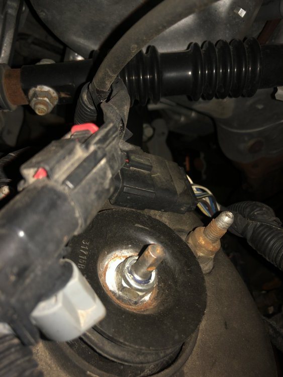

Could someone with a 2014-2018 1/2 tonne truck take a picture of the top of their strut (from above - in the engine bay) that shows the nut. I want to see if there are threads above the nut when properly torqued.
BONUS - if it was an Eibach strut I'd be massively grateful
I had a nut strip off (human error) and i will require a new strut, but first i want to see if the other side is abnormally installed.
Thank you SO MUCH for your help.

1 hour ago, James ****** said:
yes there is prob 1/2" of thread above it
Thank you James! (is your stock, or Eibach?)
That's what i thought would be the case.
Something appears to be wrong with the spring / strut assembly that doesn't allow the full height of the strut to extend through the truck mount.
I ordered 1 new strut to replace the passenger side with the stripped threads. The drivers side, i removed that nut to check the threads and they look fine.
When the new strut arrives next week, I'm taking it to a shop to disassemble and redo the installation, plus alignment. Hopefully this doesn't happen again.
Anyone know what could possibly cause the strut to be 1/2 inch short at the top? Maybe a perch or bushing installed upsides down?

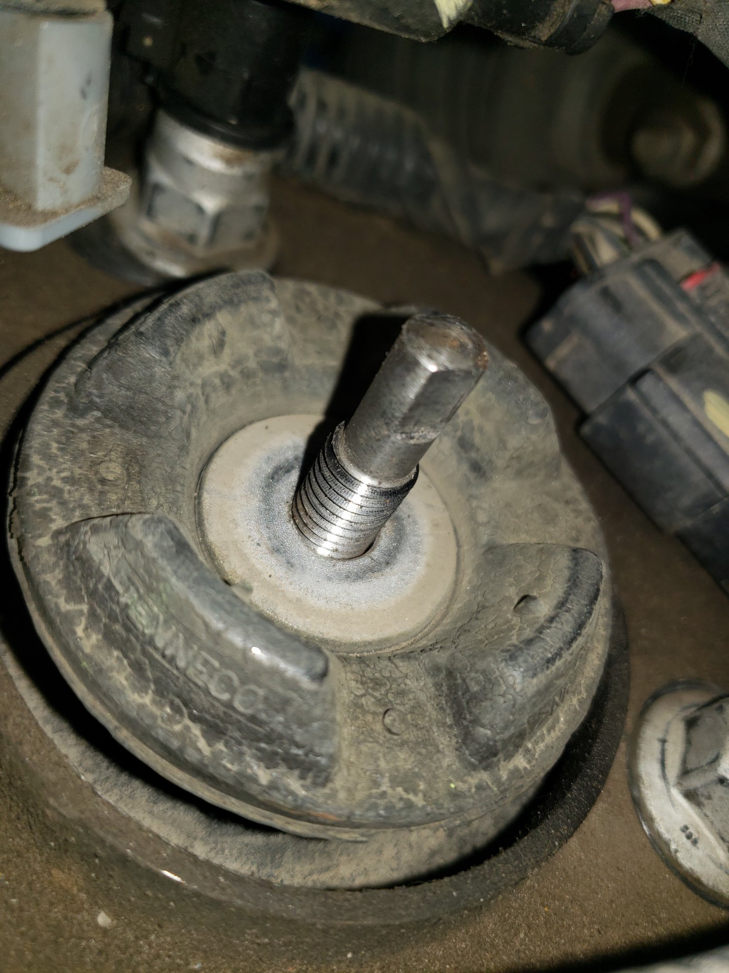

This is the drivers side, with nut and washer removed. The threads are good, but when you put the washer back on, there's really not much room at all to screw the nut.
I emailed Eibach for their opinion, waiting for a response.

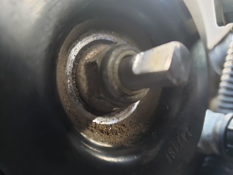

2 hours ago, HoosierZ said:
I have the Eibach shocks and springs on my truck. The threads are even with the top of the nut.
HoosierZ, THANK YOU so much, that is exactly what i was looking for....my new strut is delivered on Tuesday and it's in the shop first thing Wednesday morning
The new struts come with different locking nuts than the OEM ones.  I didn't realize this at first and need to change one of them to the nut that came with the struts.  I have an OEM on one side and an Eibach one on the other.  No issues so far.
