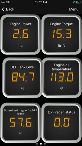

I have a 2021 Silverado with 3.0L and purchased a obdlink mx+ using bluetooth. OBDLINK recognized my 2021, under settings updated firmware, get enhanced OEM add ons - 2021 not available I selected 2019.
Dashboard has two screens one with radial gauges and the second with square gauges. set up radial gauges to have mph, eng temp, rpm, maf, fuel rate, battery
Second dashboard is square gauges (swipe screen) I set up eng pwr, eng torque, def tank level, eng temp, normalized trigger for def regen, dpf regen status. second dash board set up using add display select digital gauge next select dark next select pid next select SAE PIDs a very long list comes up i swipped to the bottom then started scrolling towards the top you will find the dep regen items select one to create a garage repeat process for other items to add
I just set up and will monitor the normalized trigger for DFP regen, currently reading 50% I believe when it approached 100% regen will start. DPF is at 0.0 do not know what it will read when regen happens
I will report back after I see a regen status. Some screen shots attached
