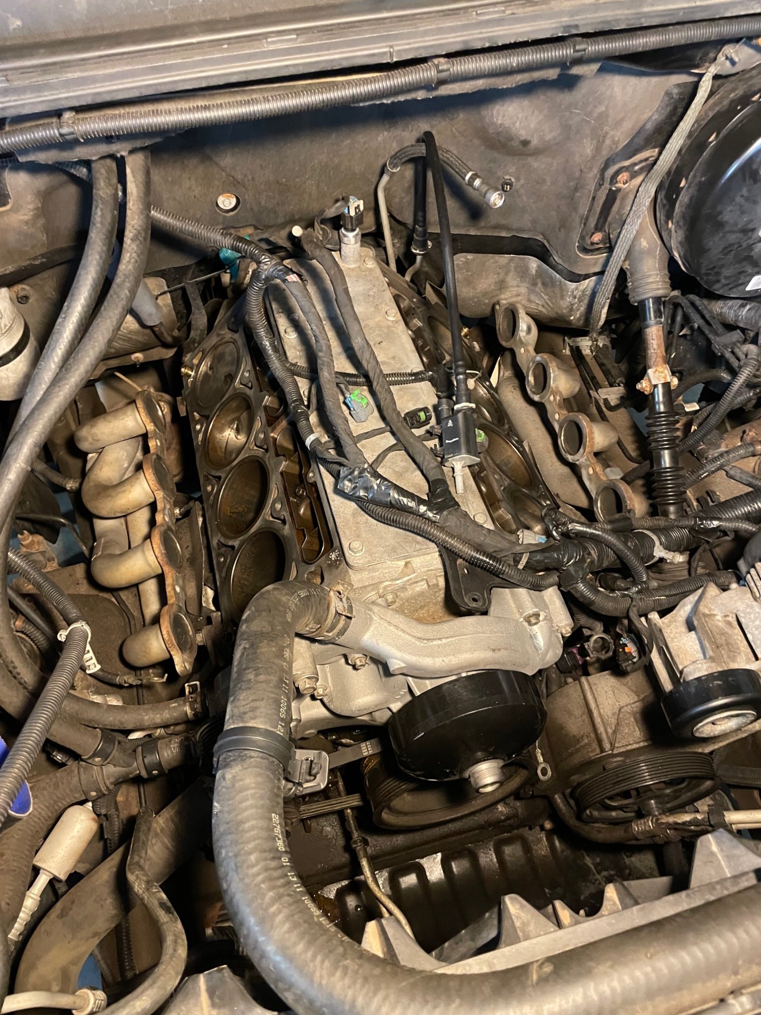

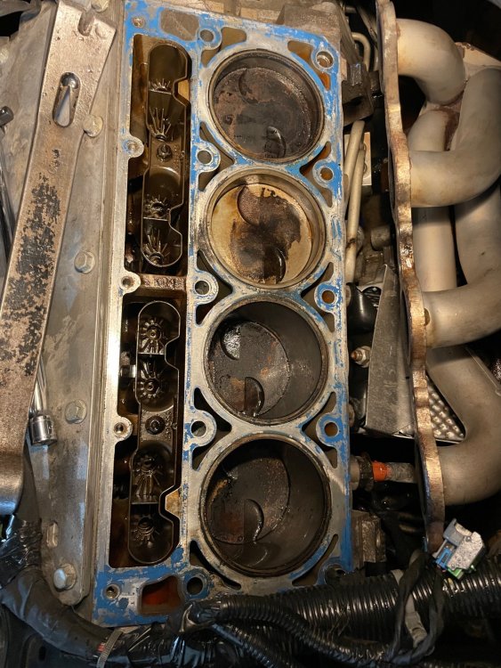

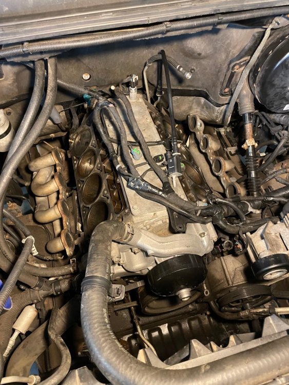

E5E2986B-C6BB-4D1A-9515-584AA470DFB0.thumb.jpeg.b1de0008d499570836b065856101da4c.jpegFinal Update:  I was wrong.  I found that my coolant was disappearing internally and upon further investigation found a blown head gasket on #5 cylinder.  I tore it down, milled the heads and reassembled with new gaskets and bolts.  It is now running strong as ever.
