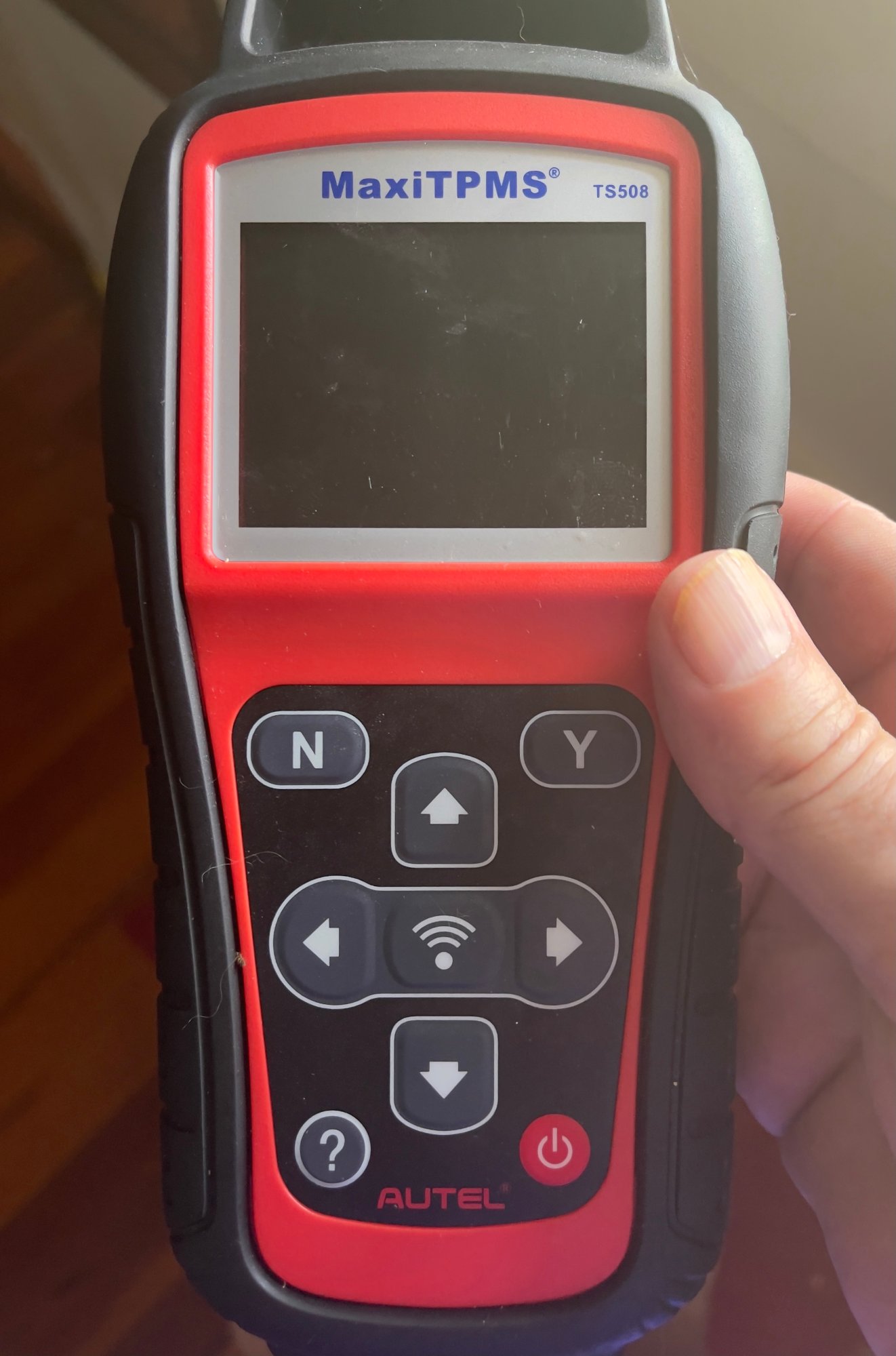

I had that issue after new rims were installed. I even bought an Autel TPMS tool to trouble shoot.
My issue would up being a low battery in the rear left sensor and the new 35" BFGs were impeding the signal from the sensor with the low battery.
Dealer replaced with a new sensor and all was fixed.

Which model did you buy?
The MaxiTPMS TS508

3 hours ago, MikeBMW said:
The MaxiTPMS TS508
Very nice, professional grade, seems about right for me🤔😬
How do you like it? Think it has the range to help Cindy in LA?
