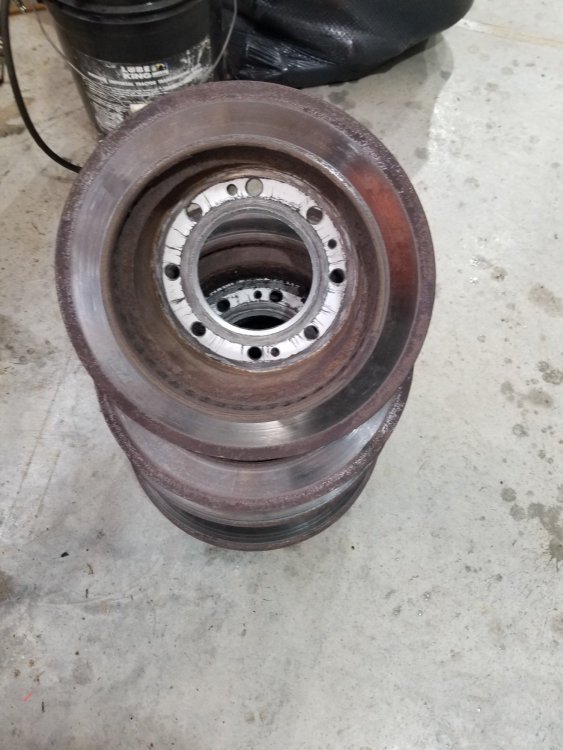

Job is done, this is what I was replacing (see pictures).  The front were the worst, the rear were not that bad.  I may save these and have them cut in the event I need rotors again (doubtful).  The old pads (Power Stop zz36) weren't bad, but I noticed (the idiot light popped) the pads were cut different.  I know I put the pads in the correct location based on part numbers, but my guess is that someone switched boxes on me...had a smaller cut pad on the front (which would still not account for the rust issue), which was most likely a meant for the rear.  Always stopped good, pads were still around 50%.
The new rotors are coated AC Delco Professional (with a China stamp) and pads were AC Delco Severe Duty.  The pads are the same fore and aft, so no worries about a  front/rear mixup.
Only one pin was partially seized, and it had been apart for a rear wheel seal at the dealer and they didn't get the rubber seal back in the caliper.  Luckily, I had a pack of replacement pins from before.
Took some time to clean things up, got different brake pin grease this time (last goo swelled all the rubber pieces).  Went together well, brake pedal effort is much reduced, stops well now.
