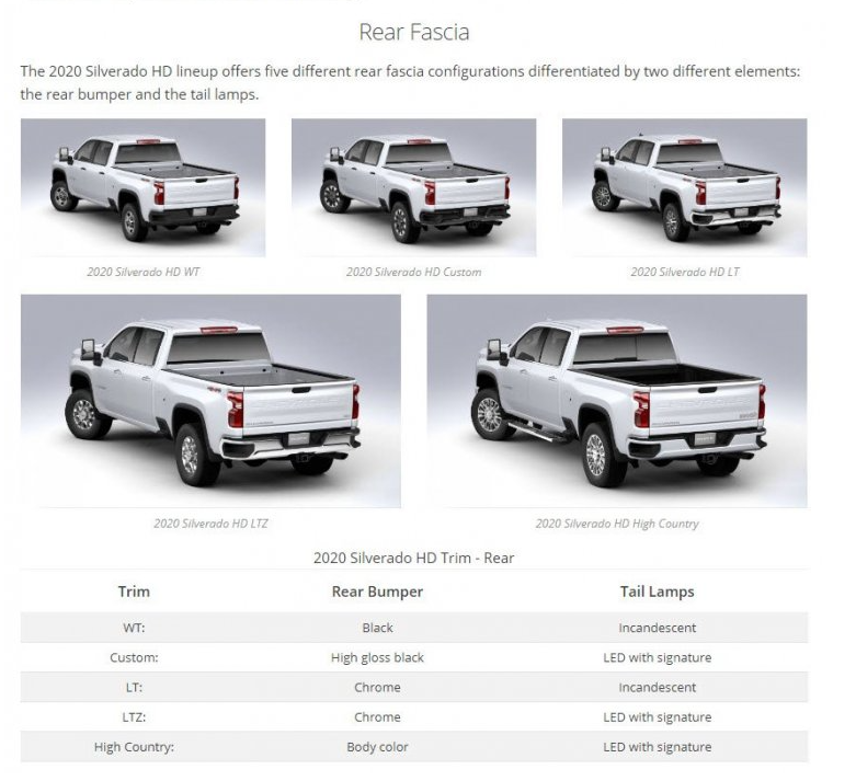

Interesting is that new to 2022, when you select the Sport Edition Package you get LED Headlights?  I just tested it on the site and it is so.
Wow, I am done for the day,  I learned something new.   I guess all you have to do is add in the rear Upscale lights.  The harness is mentioned above.  I would recommend getting the lights off Ebay.  From GM they as like $700 each.
There doesn't seem to be any rhyme or reason for how they add LED lights to these trucks. Custom gets LED tail lights and LT can get LED headlights if you get the right package. If you want front and rear you have to go up to at least the LTZ trim. Maybe that's the point, it gets people to consider spending more for the higher trims/packages.
Yeah...confusing why the Custom gets them but the LT trim does not.
