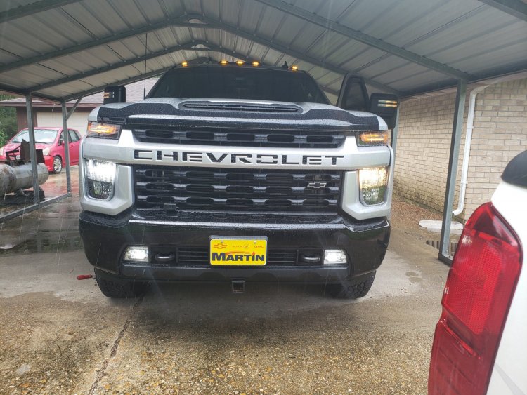

I upgraded the LT headlights in my 2020 3500 LT to a set of H11 LED bulbs designed for Reflector headlights.  I bought the bulbs from here https://deautokey.com/product/headlight-leds-for-reflector-housing-halogen-housing-fits-many-cars-including-vw-audi-jeep
Vary happy with the light output and matches the LED fog lights well.  they aren't the cheapest bulbs but they are of good Quality and designed for reflector Headlights.  I have been using there products on my VW's for a few years and haven't had any issues.  customer service is great also.
