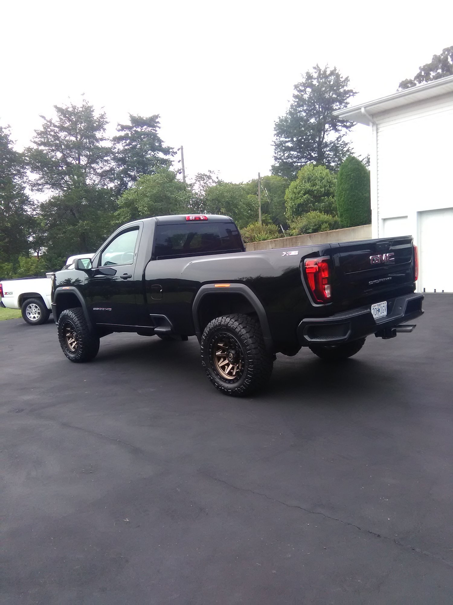

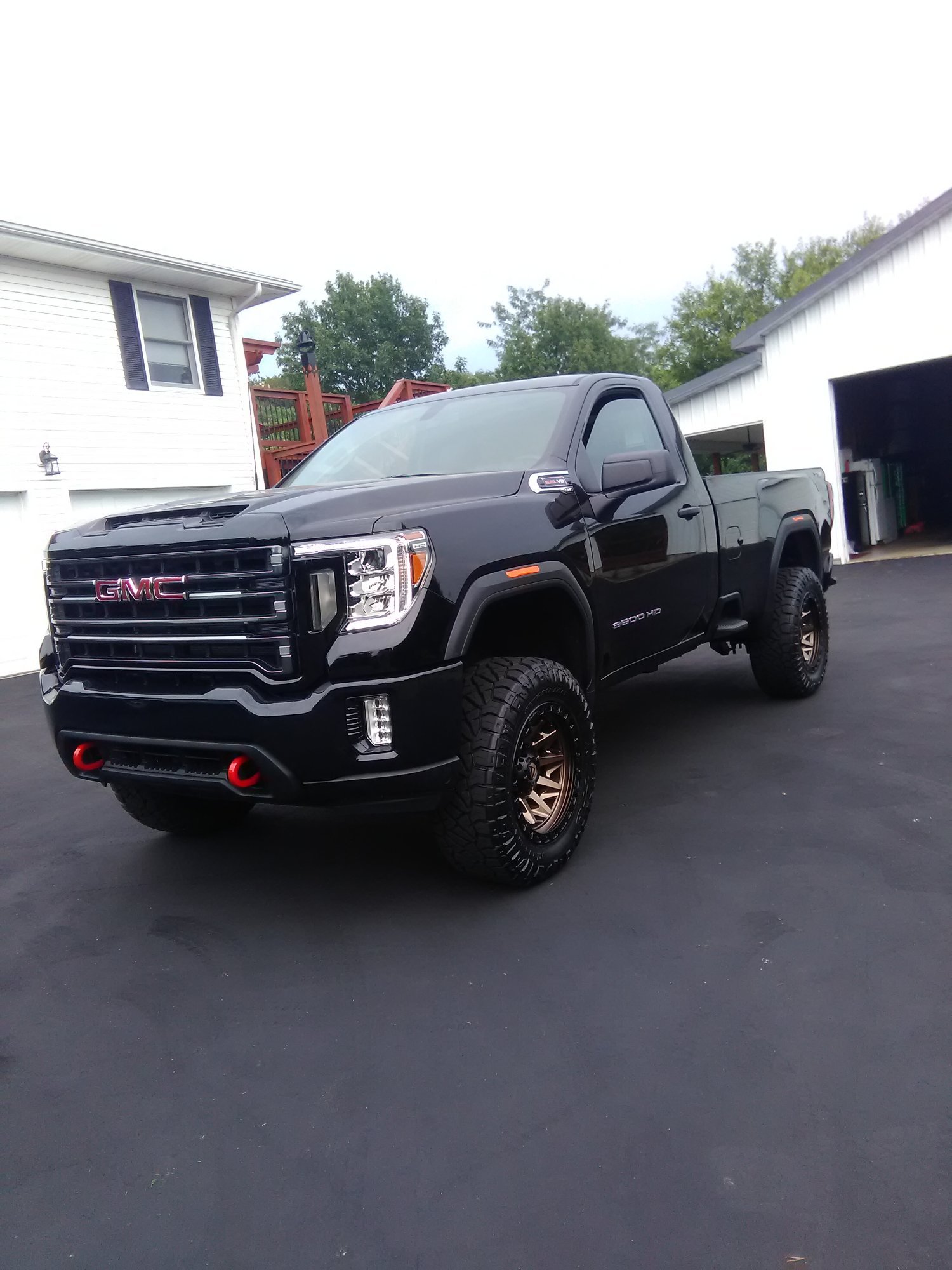

this is with 3in cognito performance kit and front diff drop, pisk kit, fox 2.0 all around. and 1in rear blocks. almost perfect level. slight rub on front but i am running 20/10 -18 fitment , its not a chevy but might give you an idea of how it sits, also i have a lot of adjustment left in the front and could easily go up more but it sits perfect to me.IMG_20210810_152428.thumb.jpg.3037ccbb05dca6a3ad9ed2dabb760803.jpgIMG_20210810_152441.thumb.jpg.19d5e7c3576ff18e45215a5413b58e9b.jpg
