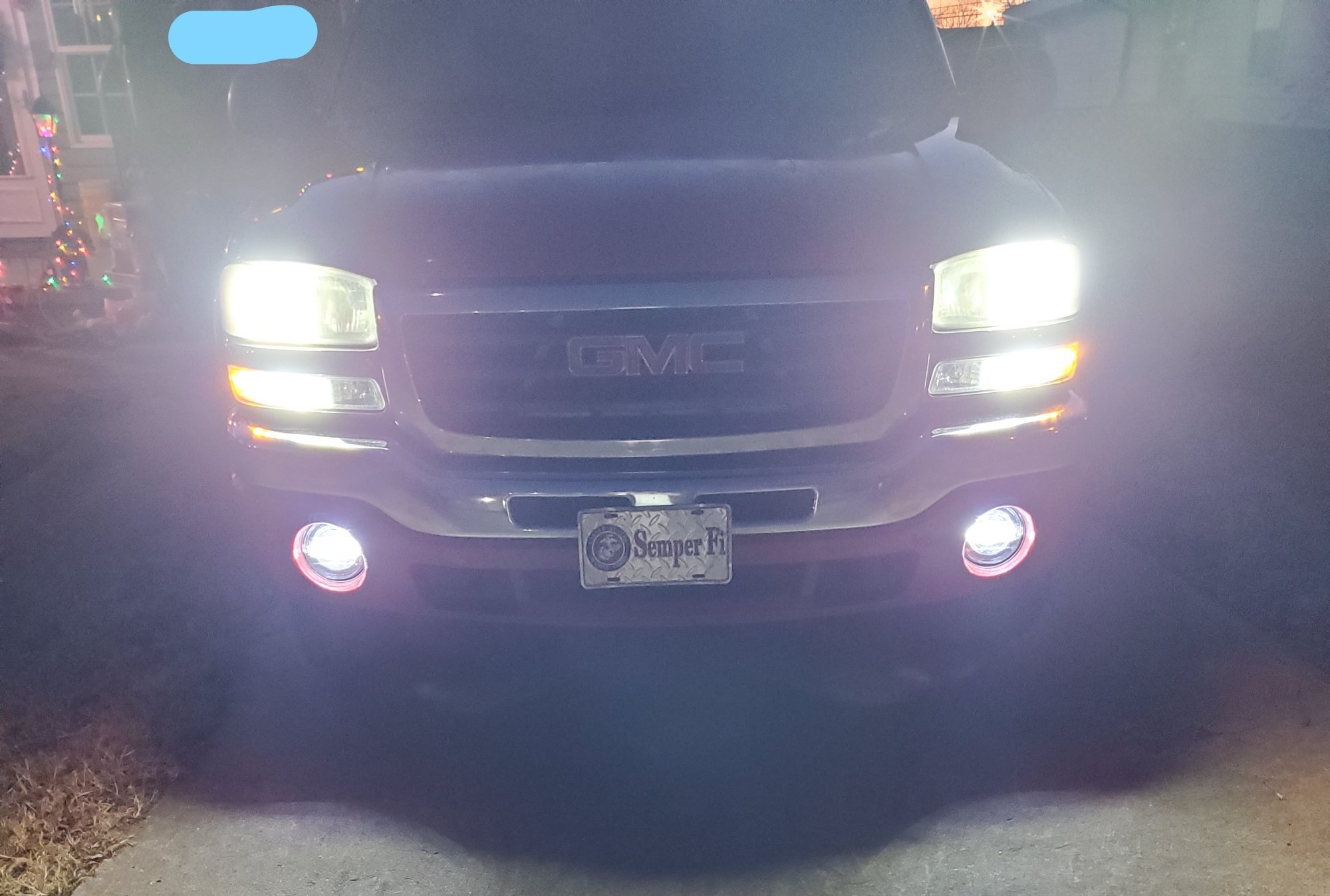

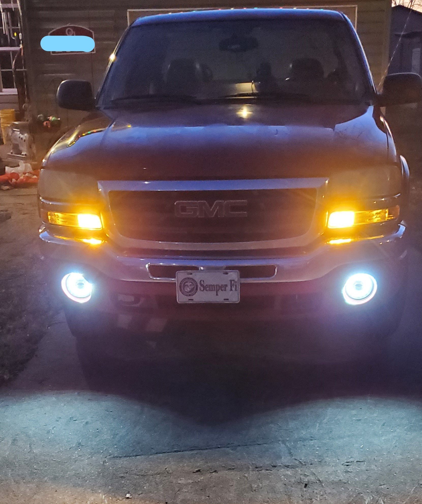

I have also used those exact bulbs for a year now, without issue.  I also changed out my running lights with LEDs with no issues.  When I did change out my parking lights, brake lights, marker lights ect, the only issue I found was that the turn signals flash faster, but they work fine.  I liked the looks so much I even changed out the fog lamps to the dfrg led swap.  Combined they give the truck an upgraded look, and very good brightness.
3 hours ago, Sharpz said:
what they look like
Good stuff thanks for sharing the pics they do look really good.  Cannot wait to upgrade mine.
