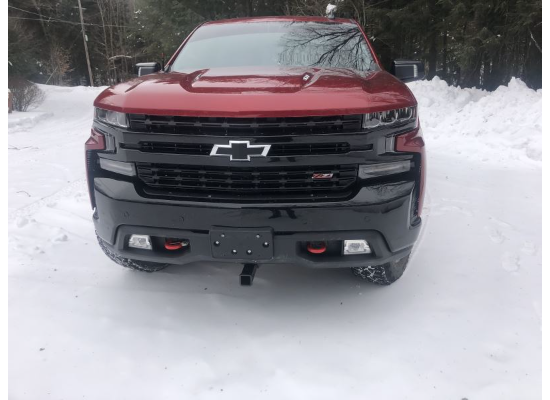

Looking to add a front hitch receiver but hoping to find one that doesn't set below the bumper but rather requires being cut through the bumper. Picture shows the Curt model which I think is too low for both aesthetics and function.

or possibly add a brush guard and add a receiver to that. they sell just the receiver tube at Tractor supply

Draw-Tite makes one that mounts right below the license plate holder. It won't work with either of the turbocharged engine options as that's where the intercooler is on those, but if you have the 5.3 or 6.2 it should fit.
https://www.etrailer.com/Front-Receiver-Hitch/Chevrolet/Silverado+1500/2021/65082.html?VehicleID=202187889
