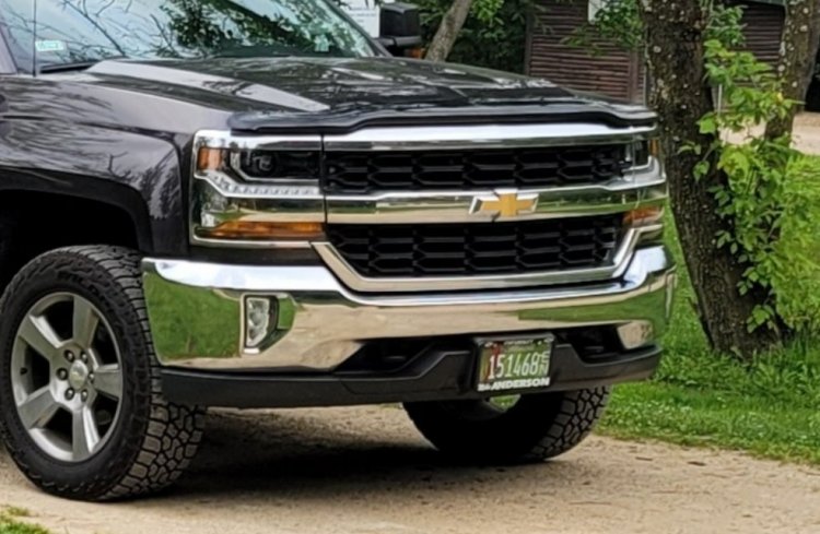

Another option on the air dam... On mine and it looks like on yours the license plate mount is part of it. (Although my Silverado isnt dropped but leveled instead ) I didnt want to drill holes in bumper to mount the license plate so the air dam had to stay. I always thought that it just sat too low. I came across several threads here that mention it is actually 2 long pieces screwed together. You can take the bottom part off which will give you more clearance and just put top half back on.
