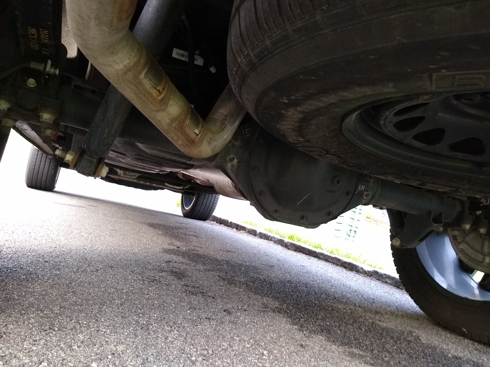

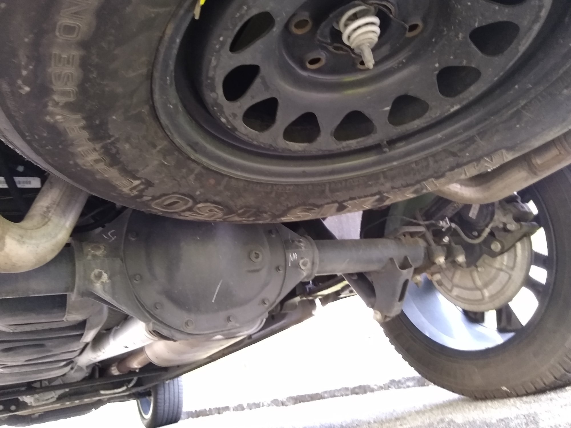

Thanks for the input. After talking to many people and doing a lot of research I decided to buy the Borla touring exhaust and ordered some factory hangers from gmpartsdirect.  I have everything I need except one item.
I need the heat shield that protects the spare tire from both sides.  Right now the heat shield I have only covers the passenger side of the spare tire.  I have searched, talked to the dealer where I bought my truck, etc..  Nobody can get me the part number for this heat shield.  I was hoping @newdudecan help.  Picture included because nobody seems to know what I am talking about.

Dual exhaust heat shield is 84535834.  This will replace the one you have in your truck entirely.  The dual exhaust shield is a one piece half moon shape if you will, not two individuals.  You might need one of 11602085 nut and 3 of 11611334.
Edited by newdude
Thanks a million @newdude.  However that part (84535834) says driver side heat shield.  I just want to make sure I understood you correctly.  From the description (and the photo) it sounds like it's for the driver side, not replacing the whole thing and covering both sides.  Again, I really appreciate your help.  I just want to make sure I am getting the correct thing.
Yea, its just labeled weird.  Its a one piece shield.  Here is the actual illustration GM has.
@diamond817 You dont think the heat shield is necessary?
I have had my dual exhaust installed without the heat shield for 22k miles so far and no issues with the spare tire. I actually removed the driver side heat shield also. And I have resonators that emit heat towards the tire, whereas the aftermarket Borla doesn't. I wouldn't worry about it too much. The exhaust just doesn't get that hot back there.
