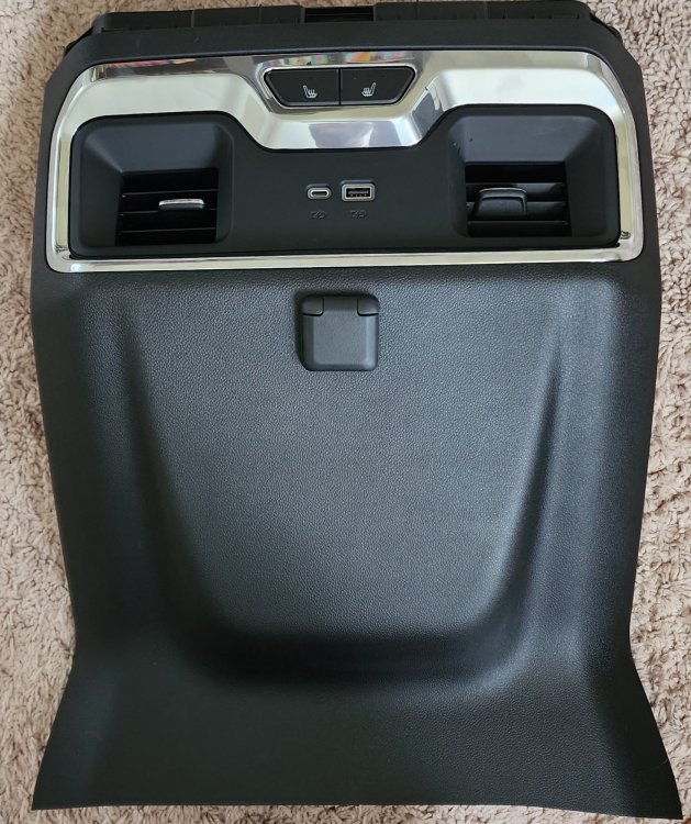

Will a USB-C to 12v adapter run a beacon??? And is either the USB-A or USB-C in centre console always on or both switched???
Thats what I figured - guess I need to wire in a cigarette plug as I need 5A. Can't believe they ditched them......

I added one to my rear seats in my 2022 Sierra just for gigs.
The mod that inspired it was the boost auto center console charging pad. Now I have two charging pads and a cig plug.
https://boostautoparts.com/products/2019-newer-gm-charging
https://www.amazon.com/dp/B008Y96IC8?psc=1&ref=ppx_yo2ov_dt_b_product_details
https://www.gmpartsdirect.com/oem-parts/gm-power-outlet-cap-84166962
Just don't load this plug over 5A if you do this, the wires you tap off of for the pad are thin.
If you wanted to just add the cig plug without the charging pad mod, I could probably find the connector you need for the plug. LMK if any interest.
Absolutely looking for just the cigarette lighter mod - had no idea was deleted until truck came in and need 5A for cooler and beacon.....
There didn't seem to be any other local 12V lines in the area of the center console to tap off of but you could easily run a fuse tap off of the driver side fuse box and fish it above the footwell and through the center console trim to get back there.

I have a 2022 RST...  same issue.   BUT... I found this site, has all the parts needed to put a 12 volt in the console...  https://www.gmpartsonline.net/ ..  I've purchased all the trim and parts for less than $60, and the stock wire harness has the plug for it, so it'll be plug-n-play, and not void the warranty.     Looking for instructions as to how to pop the trim off and replace the parts now.    Good luck in your search..
