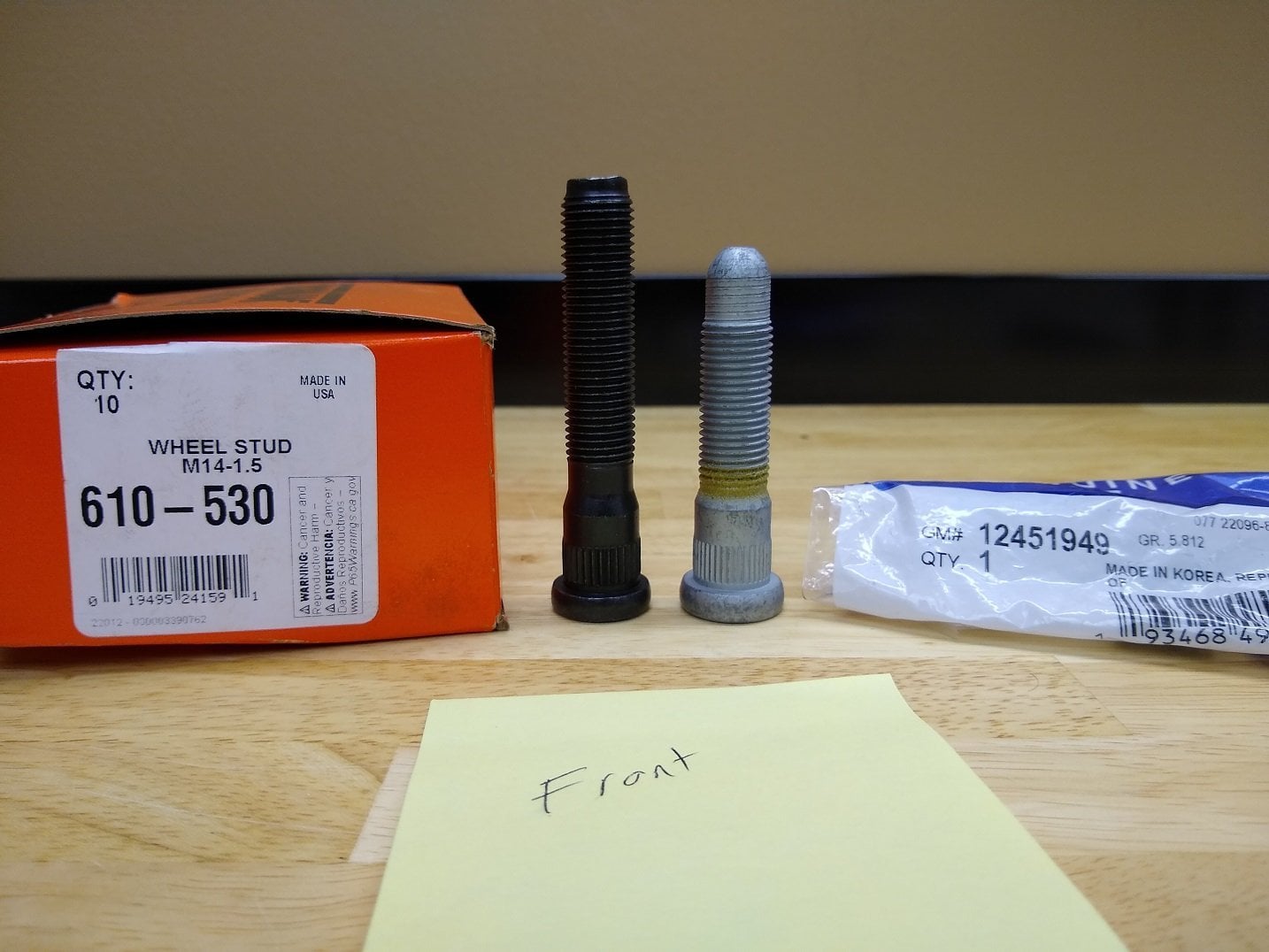

I wanted to install 3/8" wheel spacers on my 2021 SIlverado 1500 RST Crew Cab, Short Bed, 4x4. I was not comfortable with adding the spacers and having about 7 turns on the lug nuts vs having 13 turns on the lug nuts without the spacers. I wanted the same amount of thread purchase or more, so I went on a mission to find extended studs for my truck and this is what I found. These have enough threads to accomadate 3/8" or 1/2" spacers (the front and rear has about 15 turns now with the spacers on). Now, I don't know if the 2019, 2020, 2022 are the same, but these definitley work on the 2021 4x4.
Front Wheel Studs:
Stock - GM # 12451949
Extended - Dorman # 610-530
Rear Wheel Studs:
Stock - GM # 1245948
Extended - Dorman # 610-490

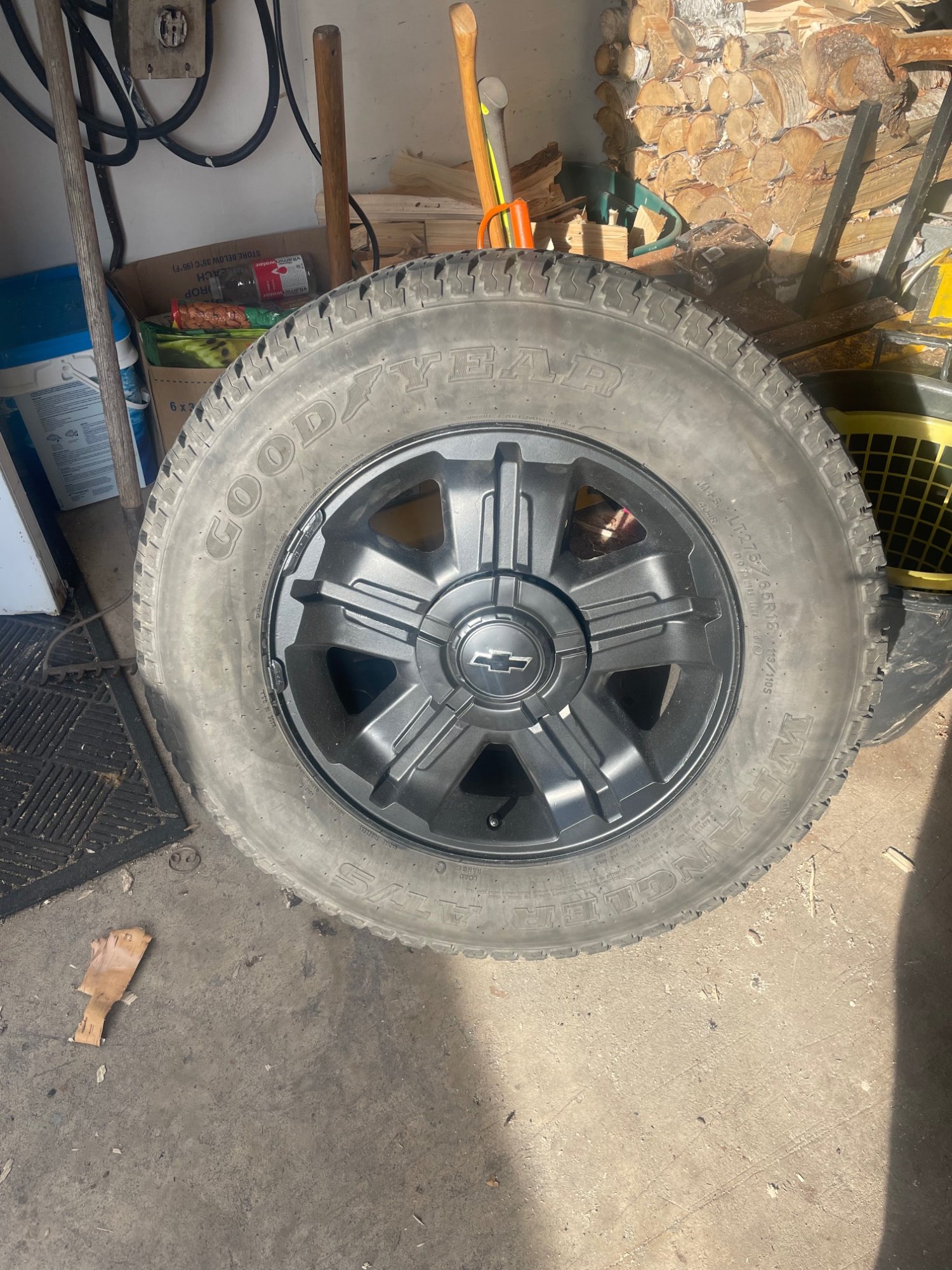

I’m trying to put older 2012 silverado wheels on for the winter but they hit the large calliper is my problem do think half inch will be enough to clear it these are the rims I’m trying to use

Only thing I’m seeing in these is for ford trucks, it’s also saying these won’t fit. Like I’m not saying your lying I just wanna make for sure they fit before I spend the money and buy them
Front Wheel Studs:
Rear Wheel Studs:
Google is only saying these fit fords
They are listed as Ford, but they are the correct size and specifications for our trucks. The part numbers I listed are correct.
They fit. I singled these studs out by measurements down to a thousandth of an inch using a micrometer.
I would think so.
