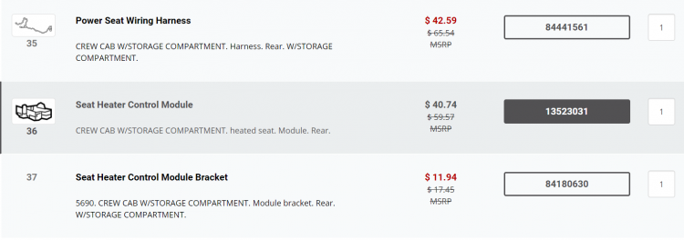

Ahhh... i got you now... so looking at the diagrams, there should be a heating pad in each side seat (#23) with a connector coming out the back to a harness (35)... I'm not sure where the harness is actually located and what it would be for otherwise. This was for a High Country since I already had it open, but I imagine it's identical.
Seats & tracks. Rear seat components.. 2022 chevrolet Silverado 2500 HD | GM Parts Direct Online, Houston TX

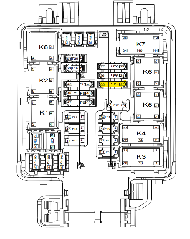

Poked around the upfitter stuff, so the fuse would be F1 on the driver side, but HIGHLY likely there won't be a fuse there. maybe they have some kind of blank fuse though? I know on my LT, that left hand fuse box doesn't even have the connectors for the fusers behind the slots. So if it has the contacts, that would at least be some good news to start.
Locating that harness and maybe even the mounting bracket would be pretty huge. Maybe someone else can chime in on the actual location if it's under the carpet or behind the rear of the seats.
