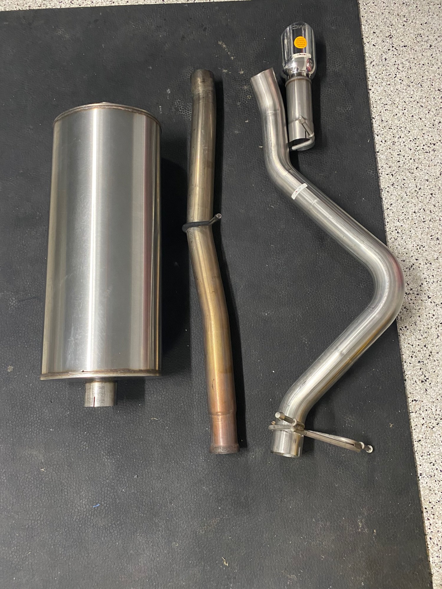

I have the Corsa made GM performance muffler I’d sell you. It is slightly quieter then Corsa’s Touring sound level. It is the same system they put on the Sierra All Terrain X. It sounded great and had absolutely no drone but was just a little too raspy on mine with longtubes. I have just the muffler or the entire cat back if you’re interested. This fits 2014-2018 Crewcabs SB or double cabs. The catback comes with a GMC etched tip. No idea where you’re located or what shipping would be though. I’m located in Tulsa, Oklahoma.

Yes 3”. Exhaust sound is pretty subjective. My opinion on too raspy might be your perfect. Here is a cold start. Loud at first but gets whisper quiet after about 45 seconds

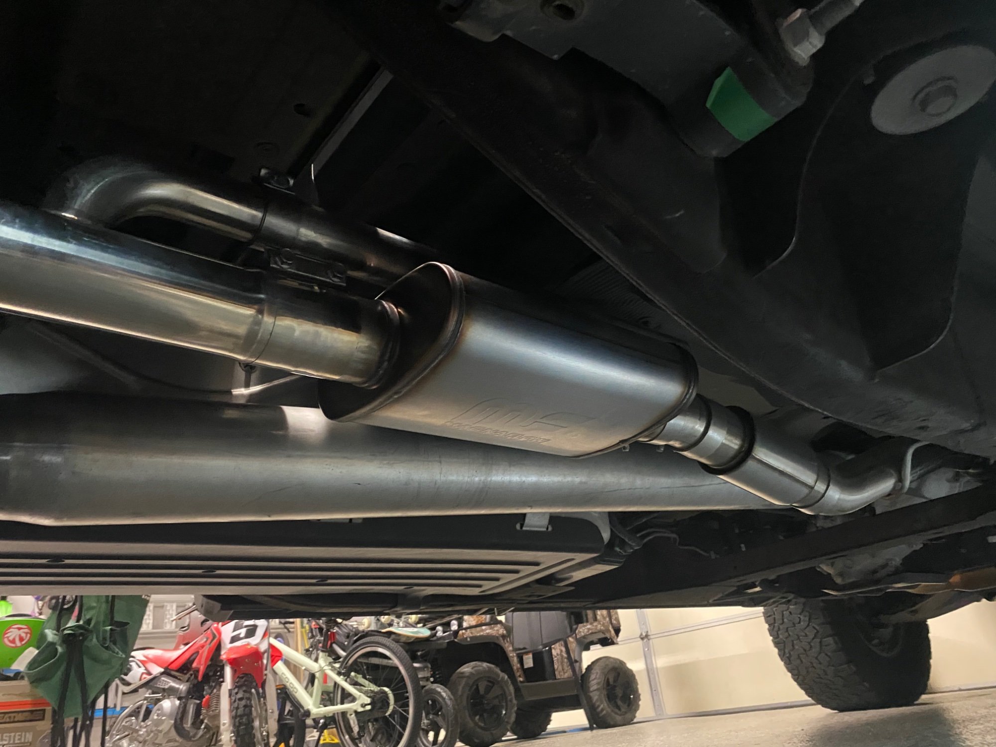

I have a magnaflow 12909 on mine with no cats and headers and it sounds great with zero drone.  But it's a 3.5 in and 3.5 out so it works really good in place of the stock muffler.  I know a guy over on performancetruks.net that just bought a used 6.2 exhaust set up for his 5.3 and put the magnaflow 12909 in the stock mufflers place for alot cheaper that those other brands and you get a 3.5" exhaust.
