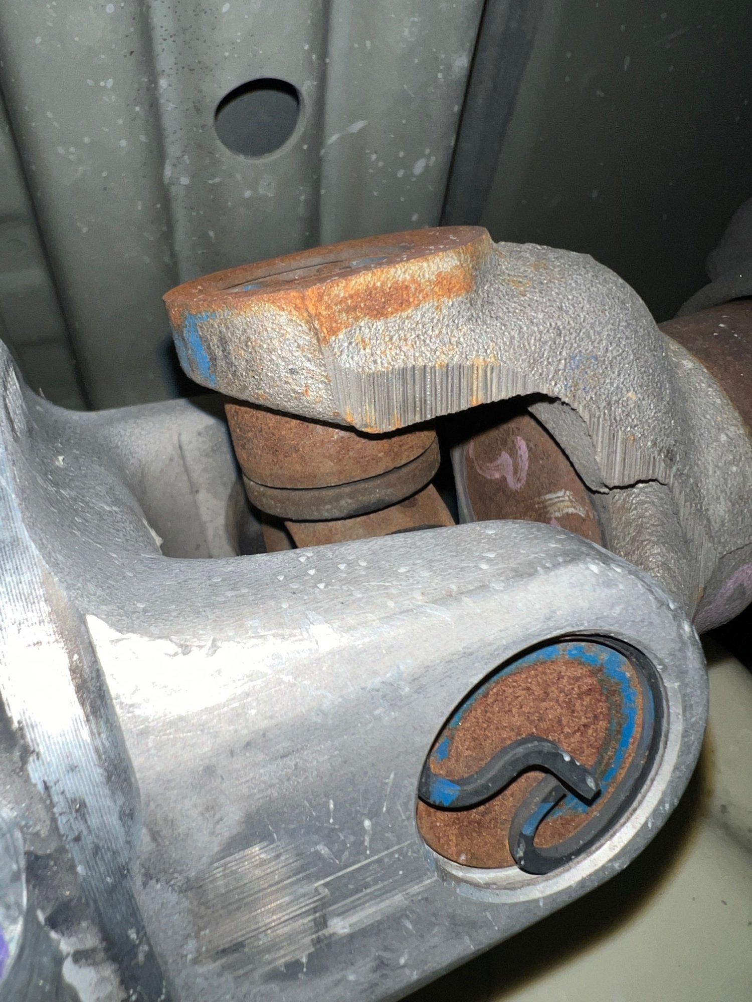

So around 60-85mph my Yukon starts shaking. I had my tires balanced an alignment done. And still shook. Did some research and it said it could be the drive shaft. So I climbed underneath and it looks like the last owners replaced that. But by the u joint it looks a little grinded down. Don’t know if that’s from installation or could be from the shaking.
Those marks are from the machining process, everything looks original to me.
If your driveshaft is shaking, it will soon cause a leak at either end, the pinion seal or tailshaft seal and soon after would destroy them both.
