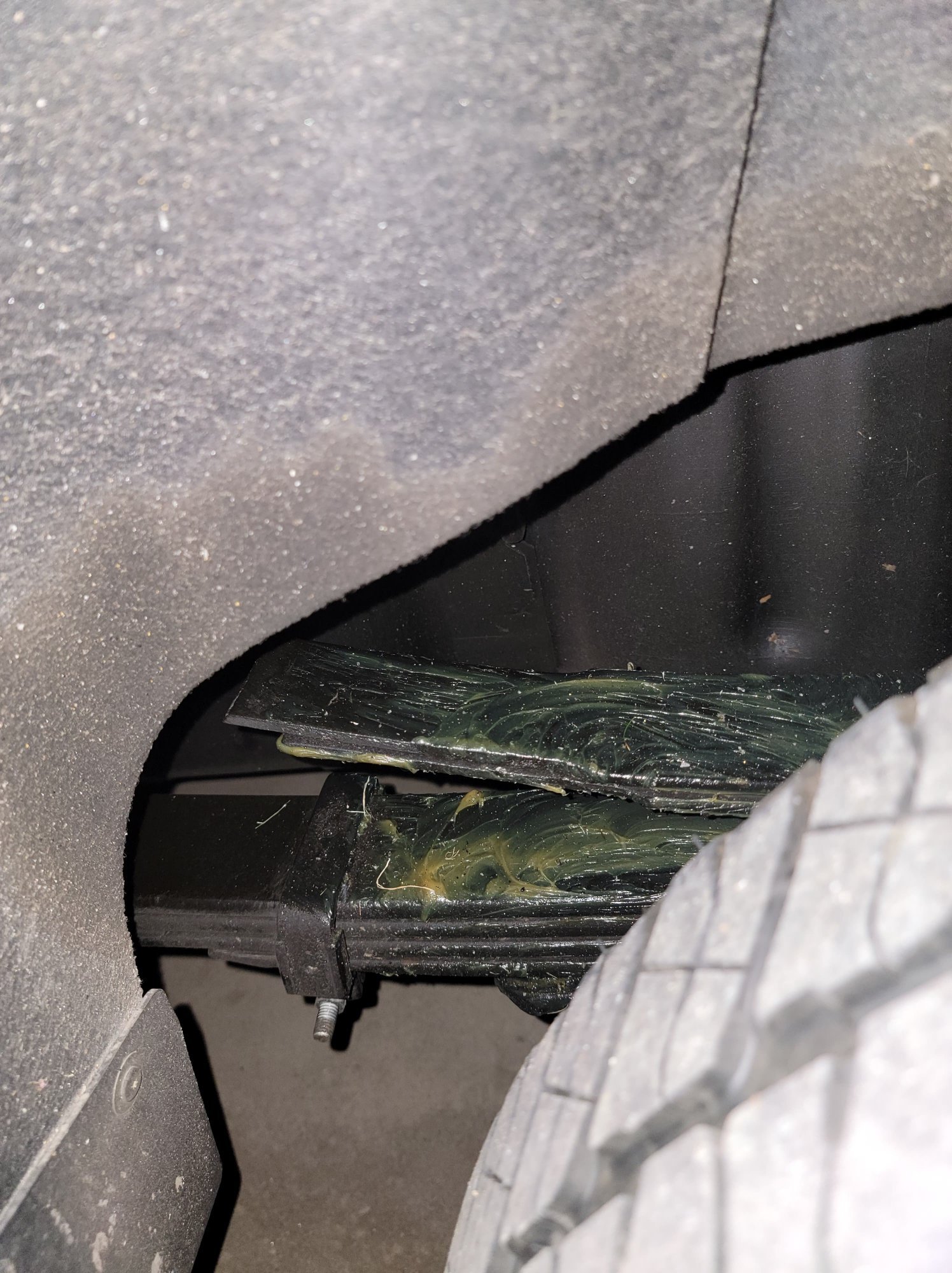

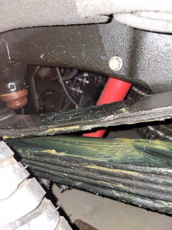

so the tech bulletin on my 2022 3500hd calls for a retorque,  generally hear it in the driveway at low speed,  had it to the dealer,  pic of when i got it out,  claimed they had to clean and use wheel bearing grease per tech support.
the specs are small stones and dirt now stuck to the springs, and noise has not changed at all.
the white speckles are stones
