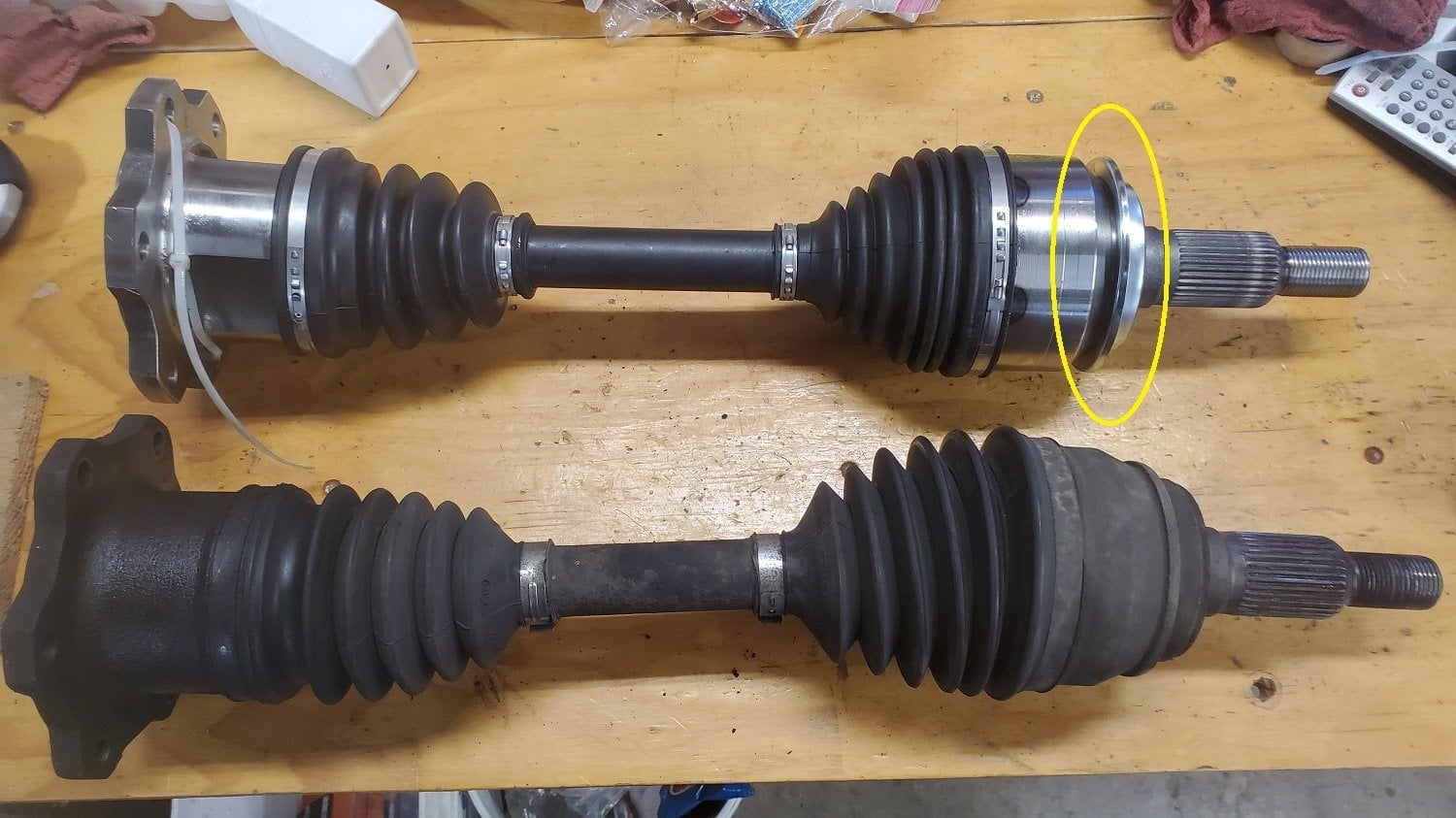

My truck is a 2006 Sierra 1/2 ton, 4x4, X-cab, SLT, 5.3 aluminum engine, with 220,000 miles on it.  I am replacing the front wheel bearing hubs (for the second time), and also intend to replace the CV shafts while I have it apart, because it is either the wheel bearings or the CV joints that are making the howl/grinding noise.  The problem is that the new CV shafts available from local auto parts stores are physically different and don't want to fit.  Careful searching at O'Reilly's by both me and their people gives a shaft with a different outer joint.  See pics below.  Local GMC dealers don't have any in stock to compare.
The replacement shafts I can find have a stamped metal ring pressed onto the outer end of the joint housing, (see yellow circle in picture) and that ring is about 1/8" too large in diameter to fit into the recess in the wheel bearing carrier.  I could take a hammer and knock that ring off, but then the taper of that outer joint housing leaves a large gap between the bearing carrier that could allow debris to enter.  I'm sure that stamped steel ring is intended as rock deflector or some such.  I know the bearing is a sealed unit, so I'm not that concerned about it.  I am just concerned mostly that this unit might have other differerences from the original shafts that could cause problems.
The original CV joint has a sort of deflector ring area that's part of the outer joint casing, which fits into the bearing carrier recess with about 1/8" clearance.  Trying to put the new design unit in makes that stamped steel ring hit the outer diameter of the bearing carrier before the shaft seats into the inner bearing race, which of course won't work.
I spoke with the parts manager at a local shop and he didn't have any answers for me, except "order one and see if it fits".  But I've already done that, and had to return it.  I'd just like to replace the CV shafts at the same time as I am doing the bearing hubs without a lot of dicking around.
Pics below, new style CV shaft on top (obviously the clean one), old dirty one on the bottom.  The offending metal ring highlighted by yellow circle.
Any thoughts or info appreciated.

Try a year older or newer to see if it pulls up a different part number that matches the shaft off the truck.
The noise I bet is from the bearing, so you might be able to put it back together although you've already got it apart...
That's the first time I've seen an aftermarket shaft like that with the bigger end on it. Pretty odd if you ask me.
