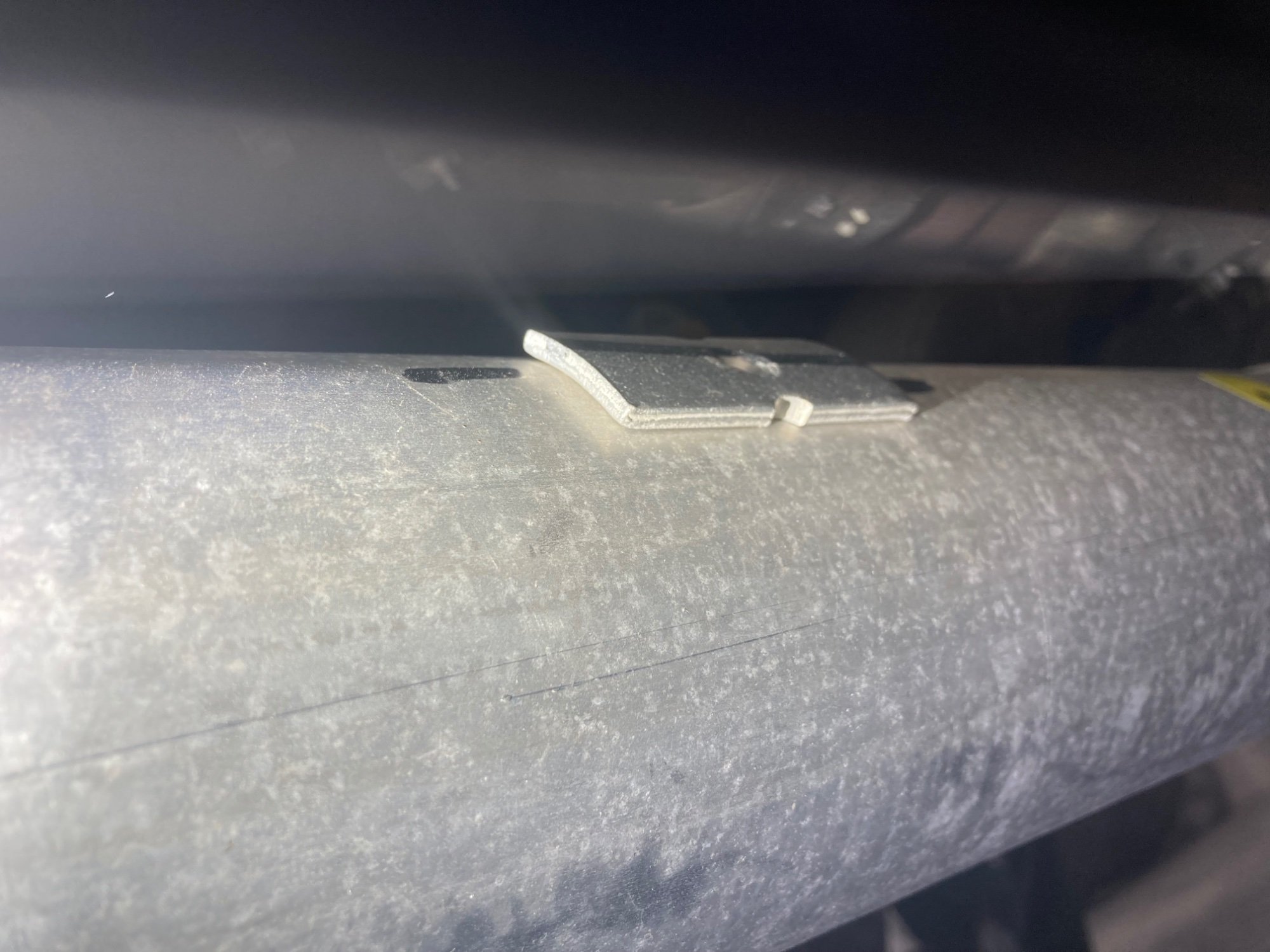

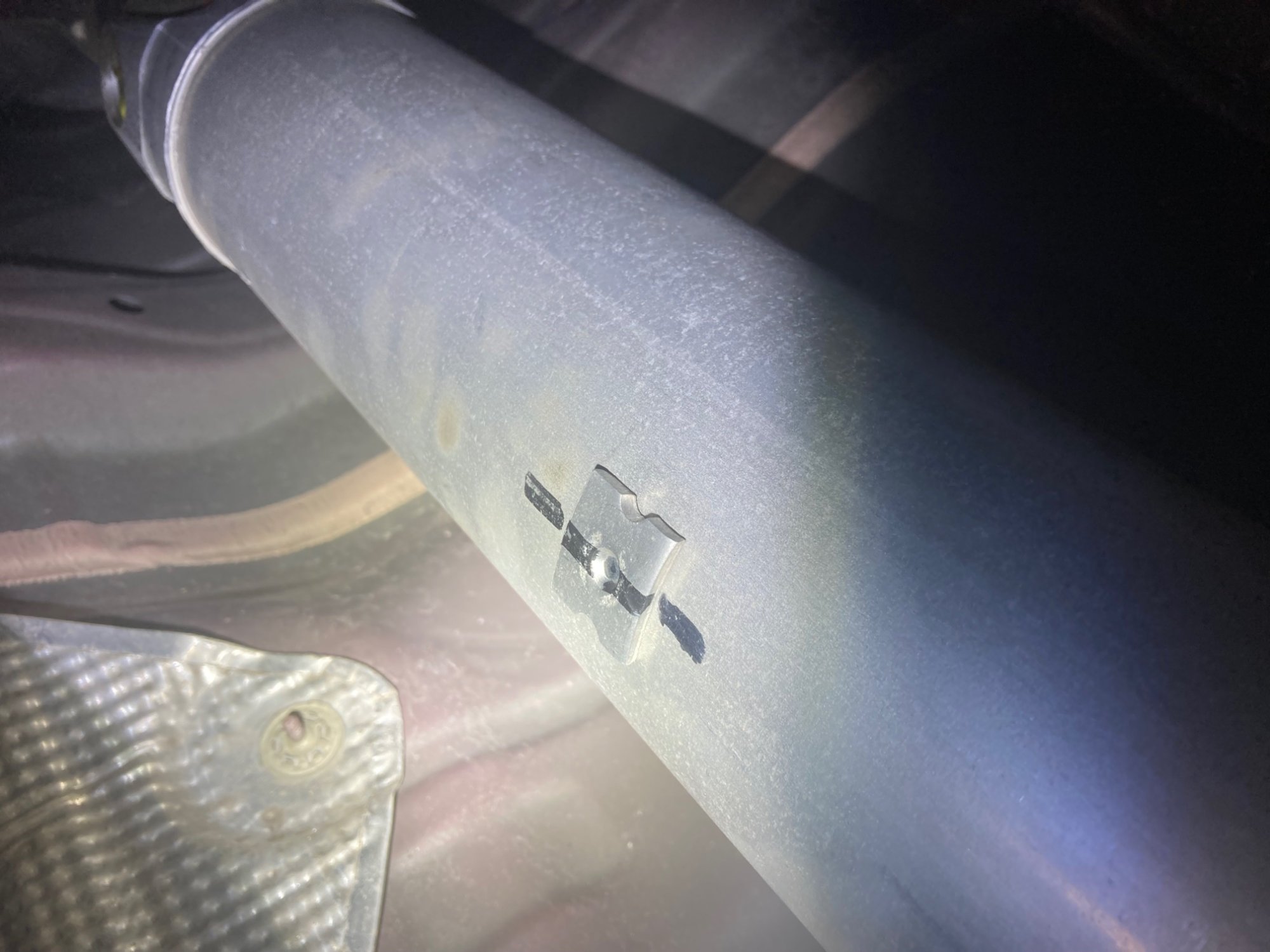

3 hours ago, Kevin0311 said:
should lay under yours and look at the driveshaft, see if can see if a weight is missing or can see where there was one, i have had carrier bearings (trucks don't have 2 piece driveshafts so no carrier bearings) going bad and cause vibration similar before. i have 3500 miles on mine, if vibration doesn't move to the front wheels and make it obvious it is a tire/rim issue and feels the same that is where i will be looking next at the driveshaft/ujoints.
Mine has 3485 miles. It irritates me why the heck dealership and GM didn't even mention those possibilities, and instead blamed my wheels/tires (which are stock), and then still say everything is within spec? I will go look tomorrow.

On 4/5/2023 at 5:33 AM, Kevin0311 said:
My driveshaft weights still intacted and marked from factory
