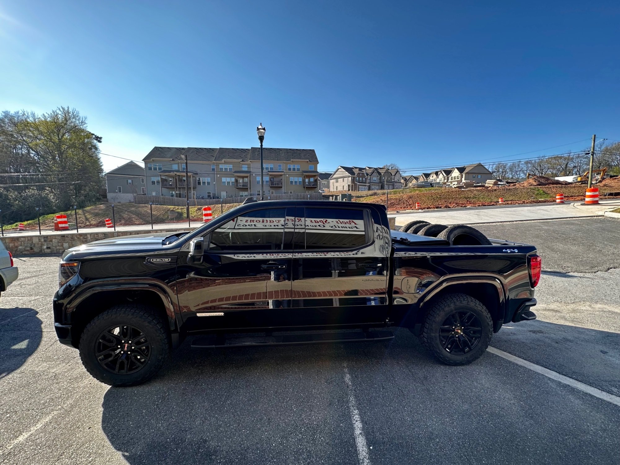

i just did a 3.5 inch lift on mine, with a 285/65r20 tire. I can’t tell any difference in camera views, lane change, or anything else. Everything works just as it did before.
