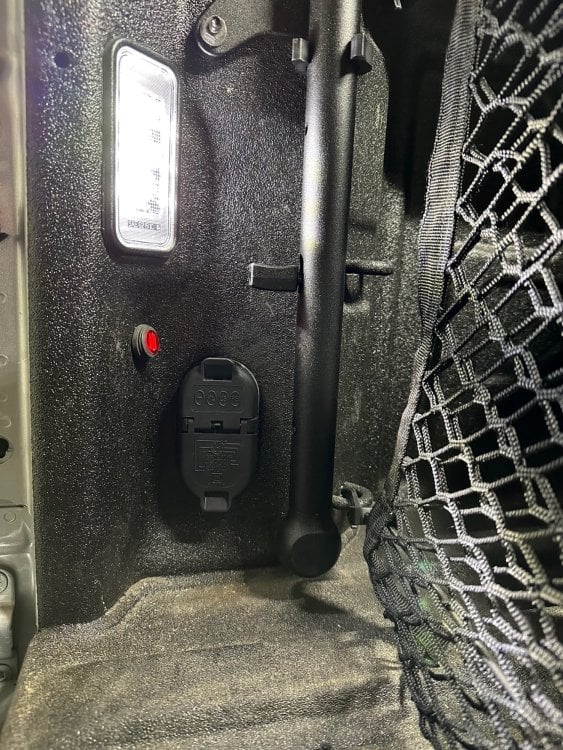

Wonder what to search for or what this handle is actually called or if anyone has the part # for it?  It's the flip up oem handle in the bed.  I'd like to add one to my truck as there is nothing to grab onto when trying to climb into the bed.  Thanks in advance for any replies.

The owners manual refers to it as an “assist handle.”

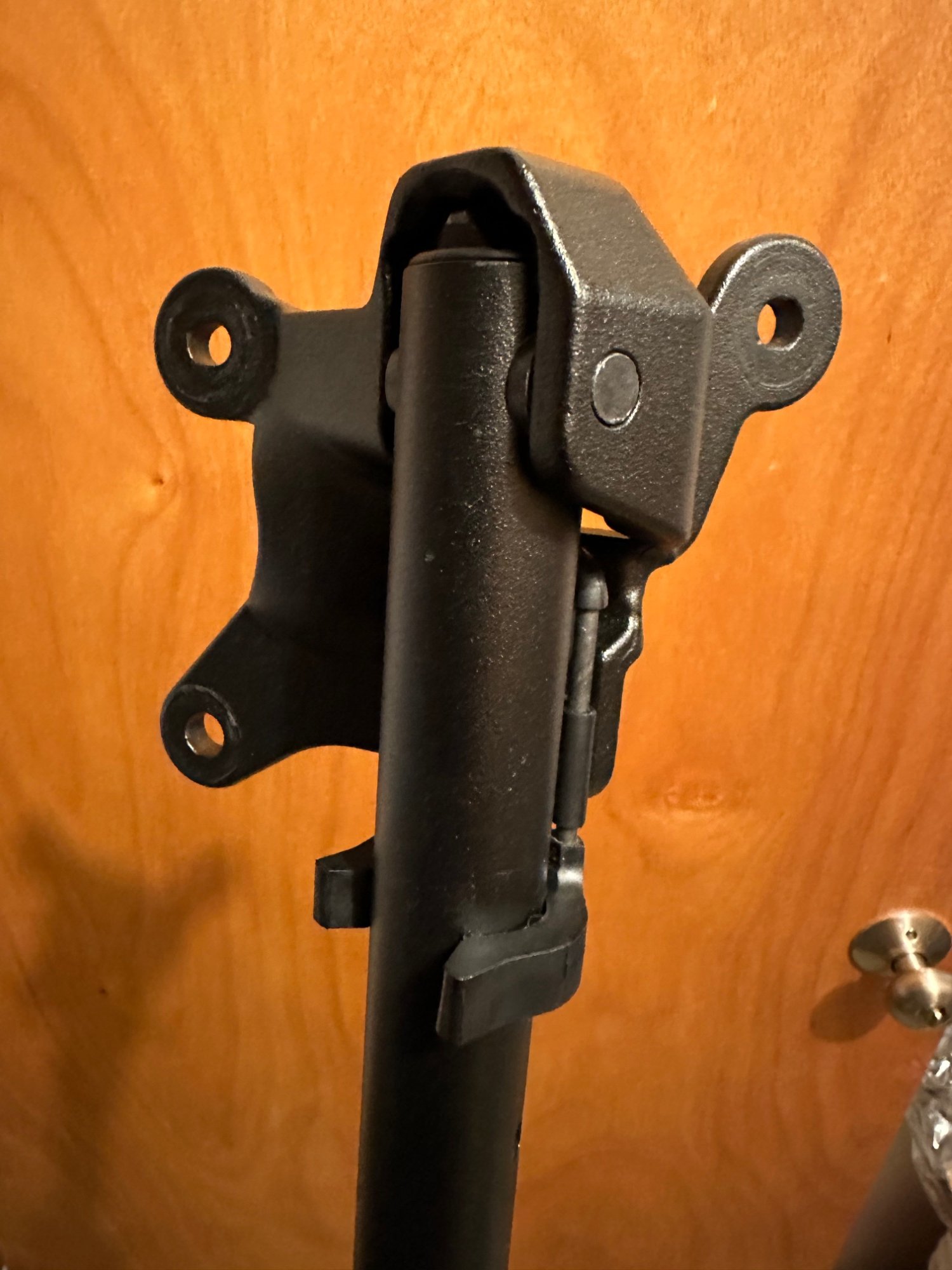

Yes. The bracket has two welded studs and you need the two matching flange nuts. Then there is a third bolt (not nut) that you need that goes into a threaded hole in the bed. My camper is installed right now so I can’t take a picture of the hole. Here is a picture of my removed handle showing the third hole on the right.

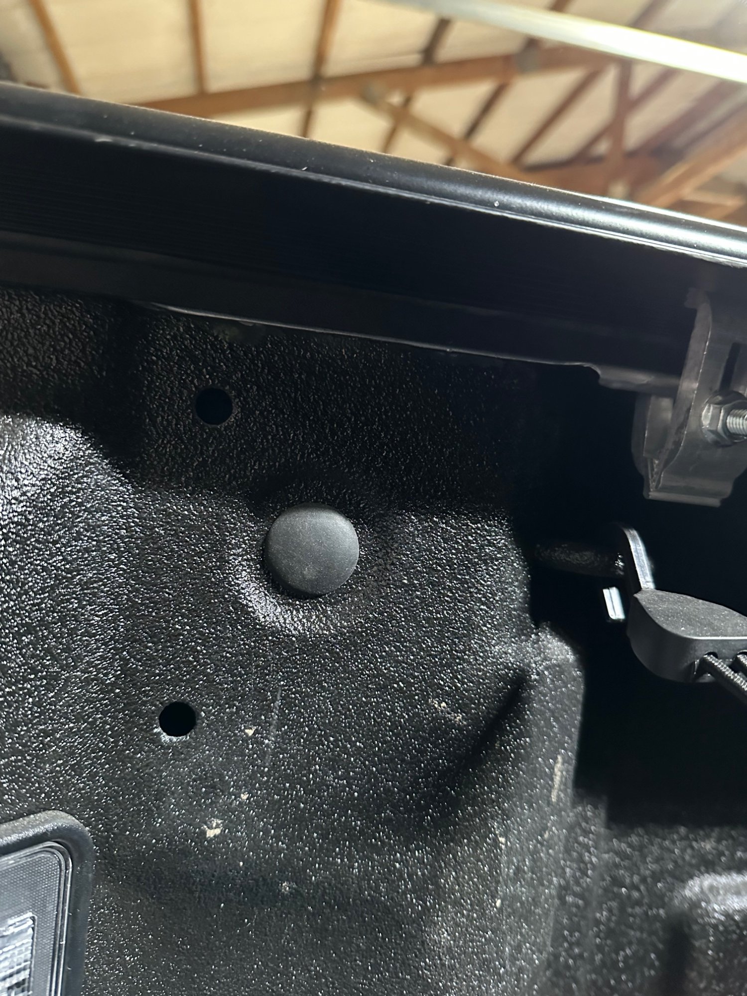

Just went out and checked and I do have the 2 vertical holes in stake pocket for bracket to go through.  However the third hole to the right isn’t threaded; just an open hole.  It’s to the right above the top anchor point.

I think if you go underneath and look up forward of the stake pocket you may have hand access to the backside of that third hole. I think on the trucks with the handle a nutplate is installed - probably spot welded in. It’s definitely more substantial than just threaded sheet metal. You may be able to epoxy a nutplate in there yourself if you can get your fingers up there.
yep, checked and I can have my son with his long skinny arm and hand stick his arm up in the bedside from below.  If or when I get around to ordering one, I'll have him reach up there with a nut while I run bolt through on the inside of bed.
