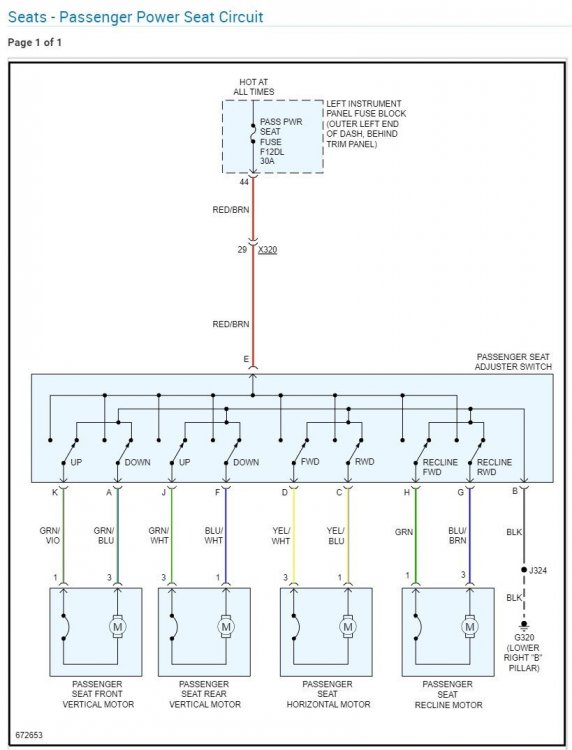

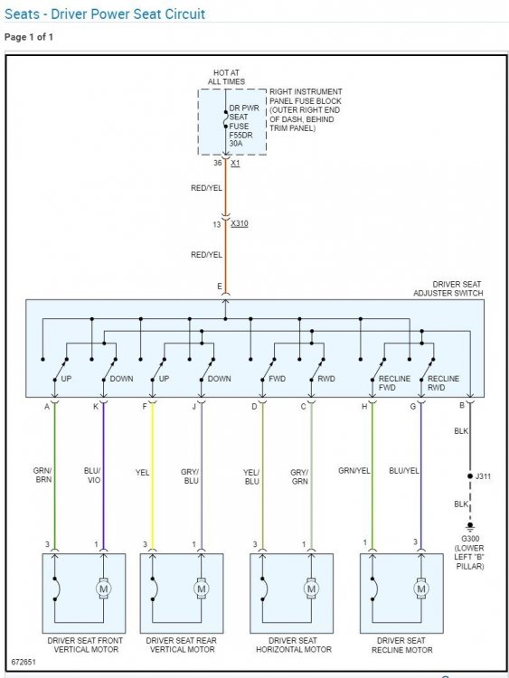

Sorry, when you click on those images they come out black.  Here they are again, hopefully this works better and you can see the color identifiers for the wiring.
  • 3 weeks later...
Thank you very much for these schematics. Would you have the schematics for the air bags on drivers side seat. I'm trying to identify the wires so I don't energize it while I'm hooking it up
