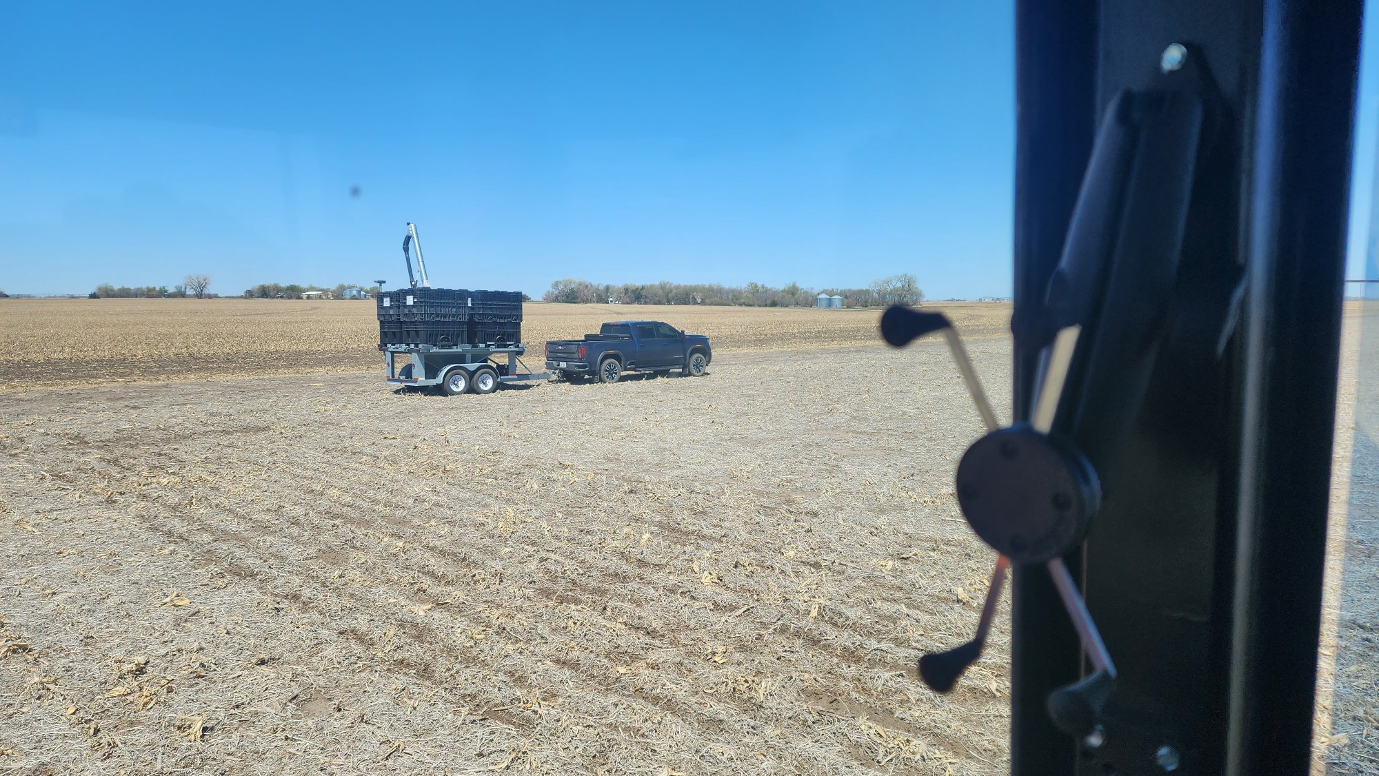

I did the same, but used the wife while I was under the truck. I used pb blaster. The creaking sound was coming from the hanger. Once it dried the creak was back.
It doesn't bother me one bit that replacement of the leaf packs was over kill. Been 1500 miles now, without 1 creak. Not my job to solve, when under warranty, even when I tried explaining to tech where the sound might be originating.
Empty or overloaded during this planting season, the sound is gone. I am happy, but this shouldn't be an issue to begin with. Leaf packs look heavier duty than I remember...
