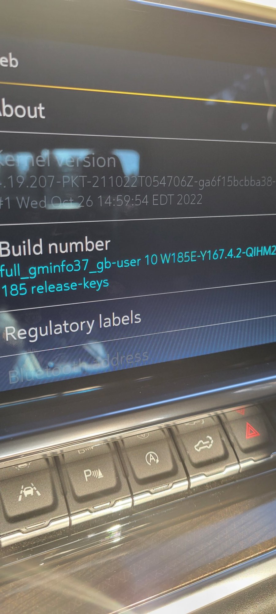

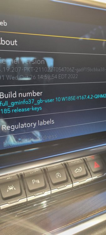

I believe you need to have your software version updated I had mine done yesterday tons of bug fixes!
Although I wasn't having this issue I believe it was on the list of things it fixed. I had mine updated at the dealer because I was not getting over the air updates 🤷 current version is 167.4.2
