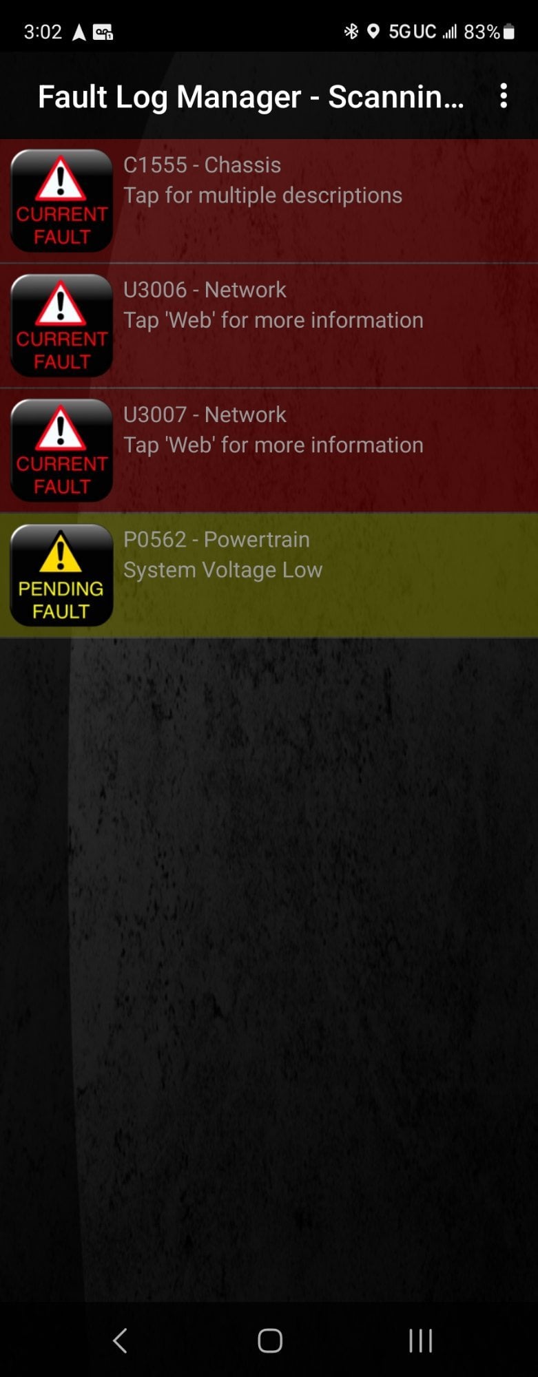

Something happened Thursday night to begin a stage of parasitic draw. I came out Friday morning to a dead battery on a 1 year old truck. Pulled codes today and this is what I got. Wondering if anyone else has had similar thing. I'm guessing since module has shorted.
i read a blog on a 2021 yukon that had the same thing as you and the same codes. dealer charged the battery and checked everything and found no problems, he is driving the yukon and it hasnt done it again
Did the vehicle attempt an update/did it show update failed on the radio screen?  There is a known issue with one of the latest OTAs getting the truck stuck in a power draw situation and killing the battery.
The C1555, that doesn't come up as a code in GM land at all so I'm thinking your reader didn't identify it correctly or can't identify what is actually there.  The other three are all low voltage codes.

I updated manually a few weeks ago so no update available. Every night after charging the battery since it originally happened I've come out the next morning to dead battery. Whatever it is is drawing more than 6v 2amps that my battery tender puts in.
