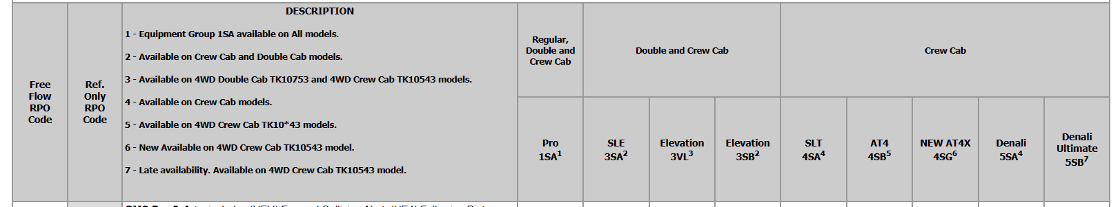

Don't know if there is a way for you to do it, but the order guide says the (BTV) remote start is included and only available with WPB Graphite Edition on 2023 1500 Pro.
All other trims it shows as standard.

You are going to have to wait for a GMC kit to come out.  Right now there's only one listed for the Chevrolet trucks.  I checked the engineering notes too hoping to find a # to use on GMC but there is nothing yet.
App remote start won't work without installing the accessory remote start kit.  Truck needs the programming, then it takes about 2 weeks for the onstar data to refresh and then the app will allow remote starting.
