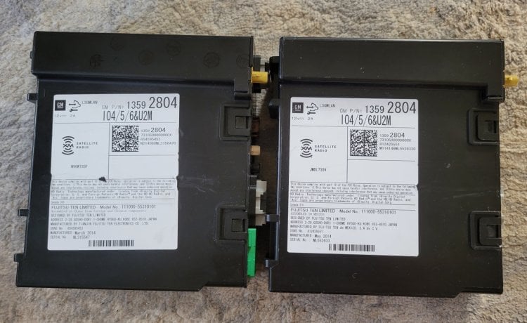

I recently had my radio checked out and was told by the dealer that my radio control module was bad so I found one with the same numbers on eBay and purchased it. After I installed it, none of the radio functions worked properly. Buttons that I pushed didn't do the proper command Does this new control module have to be programmed to the truck?
In the photo the original is on the left and the new one is on the right
There are some OBD2 scanners that allow you to update modules. If you do a lot of your own work they are worth getting.
If memory serves correct, you can buy them preprogrammed, or not, but it will have to programmed by the dealer at some point to work.

The OP was a 2 post and gone. If you do need to swap out the module it's best to get ahold of https://www.whiteautoandmedia.com
They can program the modules.
