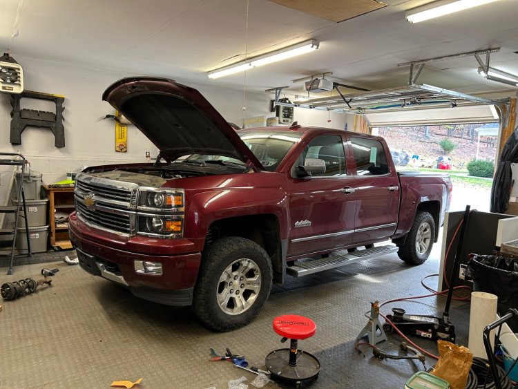

It is time for me to refresh my 2015 Silverado 1500 HC with struts and shocks (definitely overdue), a wheel bearing that is starting to roar louder, and the Ac condenser which has finally started leaking. I already have a condenser and a wheel bearing ready to go in but am undecided on what to do about the shocks and struts. I am looking to get a little lift out of it so that why I am leaning toward Eibach or Rough country which are in my budget.
Eibach is attractive knowing it is made in the USA. I guess it would require me to buy some UCA's. The Rough Country kit comes complete so that makes it somewhat attractive to get. If I go with the Eibach kit, will I need to get a differential drop kit like with the Rough Country? I have read other threads on here that people like the Eibach set up but haven't read that they drop the differential.

OK Finally installed my Eibach kit and Rough country control arms. Everything went pretty good on the install. Found my driver side sway bar end link was broken off at the bottom. Had to make a trip to NAPA to get a new set of end links.  Installed as the came out of the box and was surprised to see that the lift on the front went from 36.625'' before and 40.25'' from the ground to the fender. Now after driving for three day the front has settled and is measuring 39.25''. I have to decide what tires to get and get a alignment. I am going to adjust the coilover just a little to make it a total gain of 3.5''. Stop by the local tire shop to as about tire size. I plan to stay with the stock 18'' wheels.  I do need to do ad a spacer since the tire does hit the control arm at full lock. Rough country does mention that you will need a .25'' spacer on their website. The guy at tire shop suggest I use a 1'' spacer because the .25'' one would take away the hub centric part of the hub for the wheel. Have a coworker who said he probably has a set of blocks for me to level the rear up once I know what I need.
Edited by maronha
After thinking about everything I may just get new wheels instead of running a spacer.
After driving for a week, I am noticing some clunking when turning a very low speed. I know I have everything tight because I double and triple check it all. Going to check again but was wondering can over torque cause the clunking?
