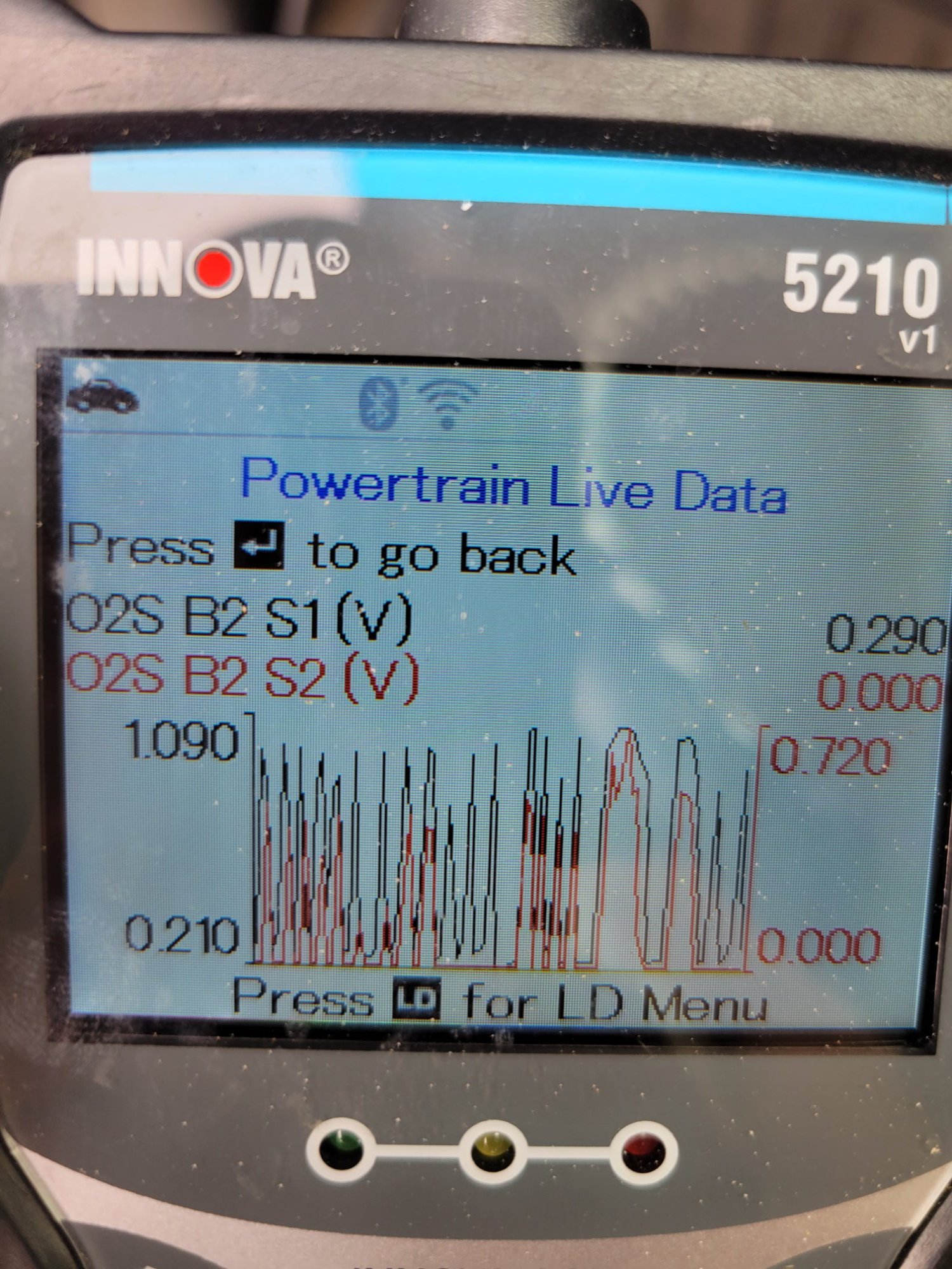

But as you see in pics , problem is on bank 2.

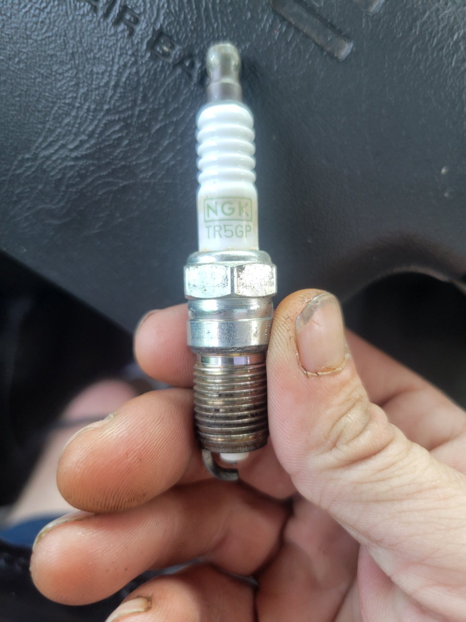

Some of the spark plugs keep loosening. Like very loose. I  Never had that problem , they are the right size too .
The 2 pics of 02 banks volts I'm thinking shows at bad B2 CAT . I I right on that?
What brand and part number plug did PO use? These engines kinda like AC Delco and NGK and the correct number already correctly gapped to .040. Platinum or Irdium. Higher mileages, I'd just go with Plats. Answer my first question.

Plugs becoming loose, that S_ _ t ain't right. txab is right; just because the guy installed this 'n that sure doesn't mean he bought first quality parts. Most better plugs these days are pre-gapped too so that's kind weird... Installing a PCM is big stuff, I have never done it (knock on wood) but it is certainly something that has to be done "By The Book", I'm a big btb guy having worked on Uncle Sam's stuff for 38 years.
The PCM would need to be programmed for the vehicle. A crank relearn would need to be performed also. Grabbing a junkyard PCM doesn't always cut it. I've swapped PCMs due to tuning. No issues when the steps are followed. Yes the loose plugs are concerning. That's why I wanted to know brand/part number.

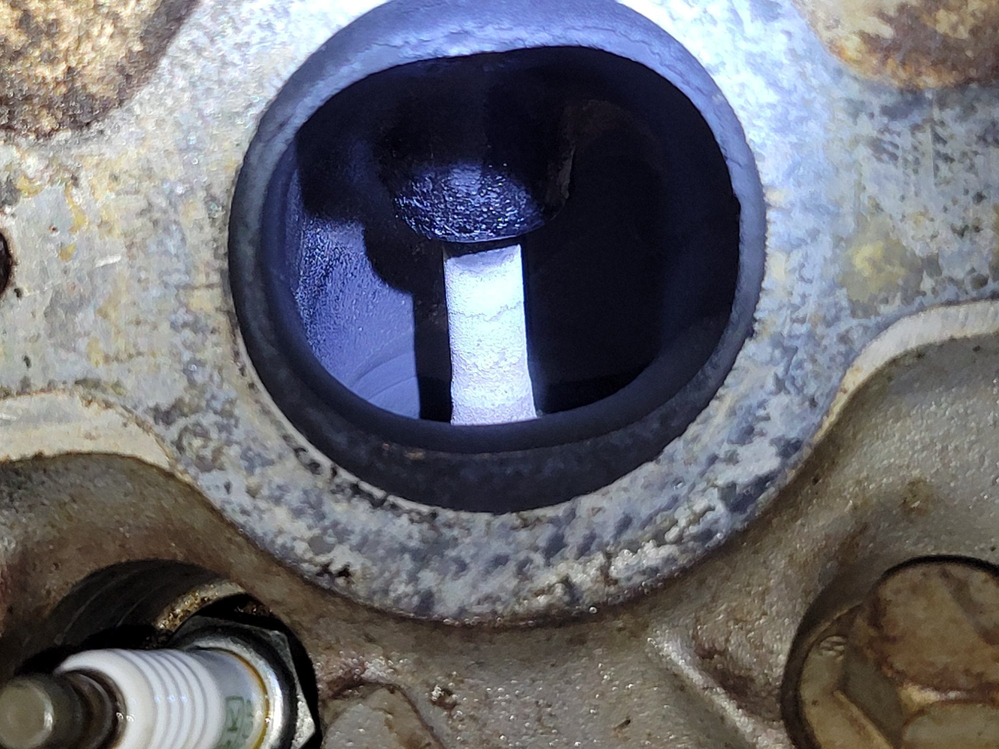

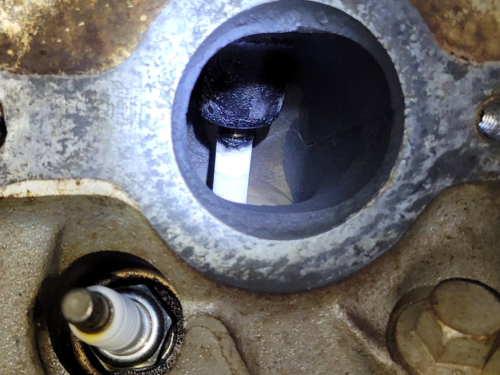

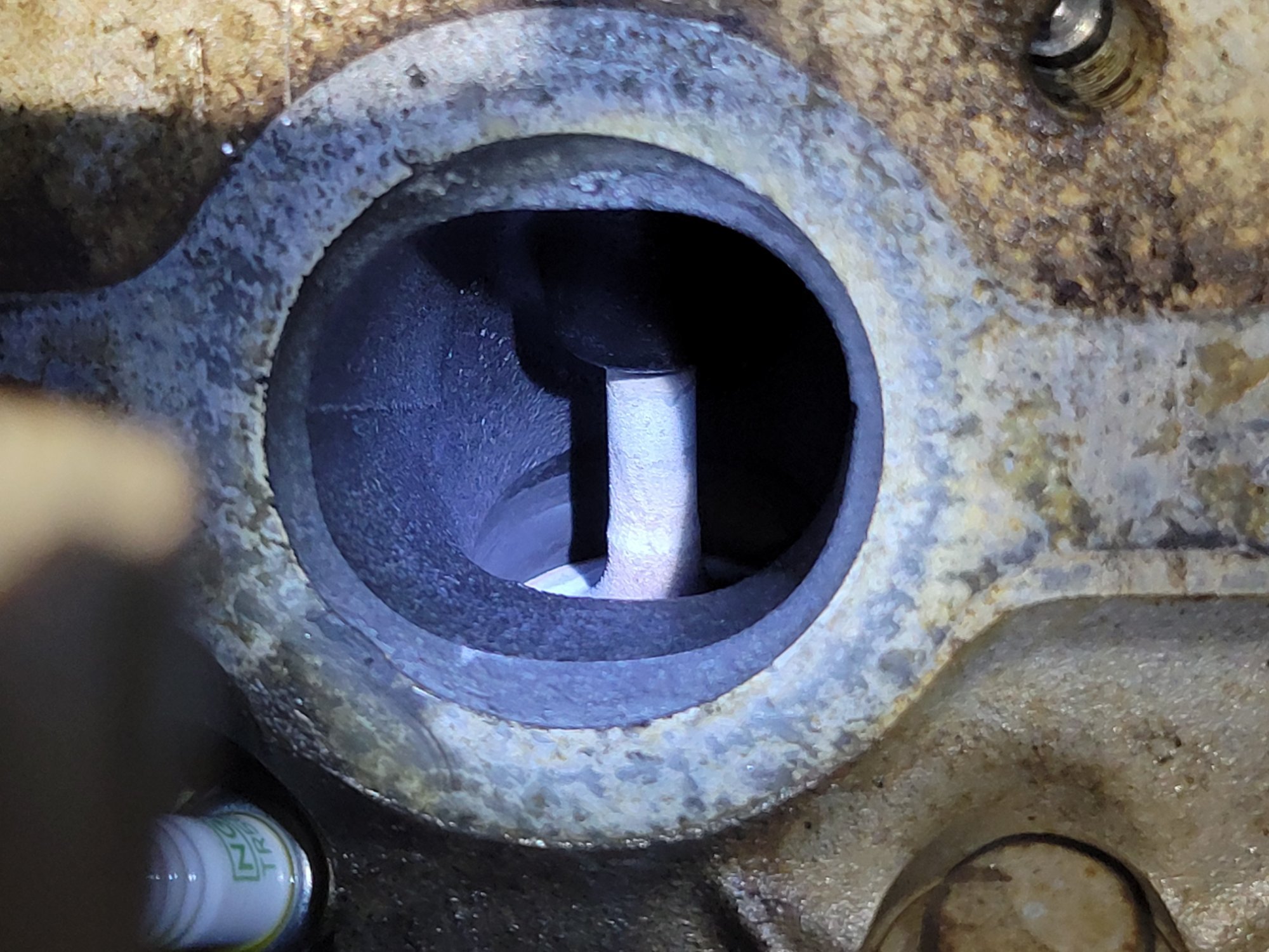

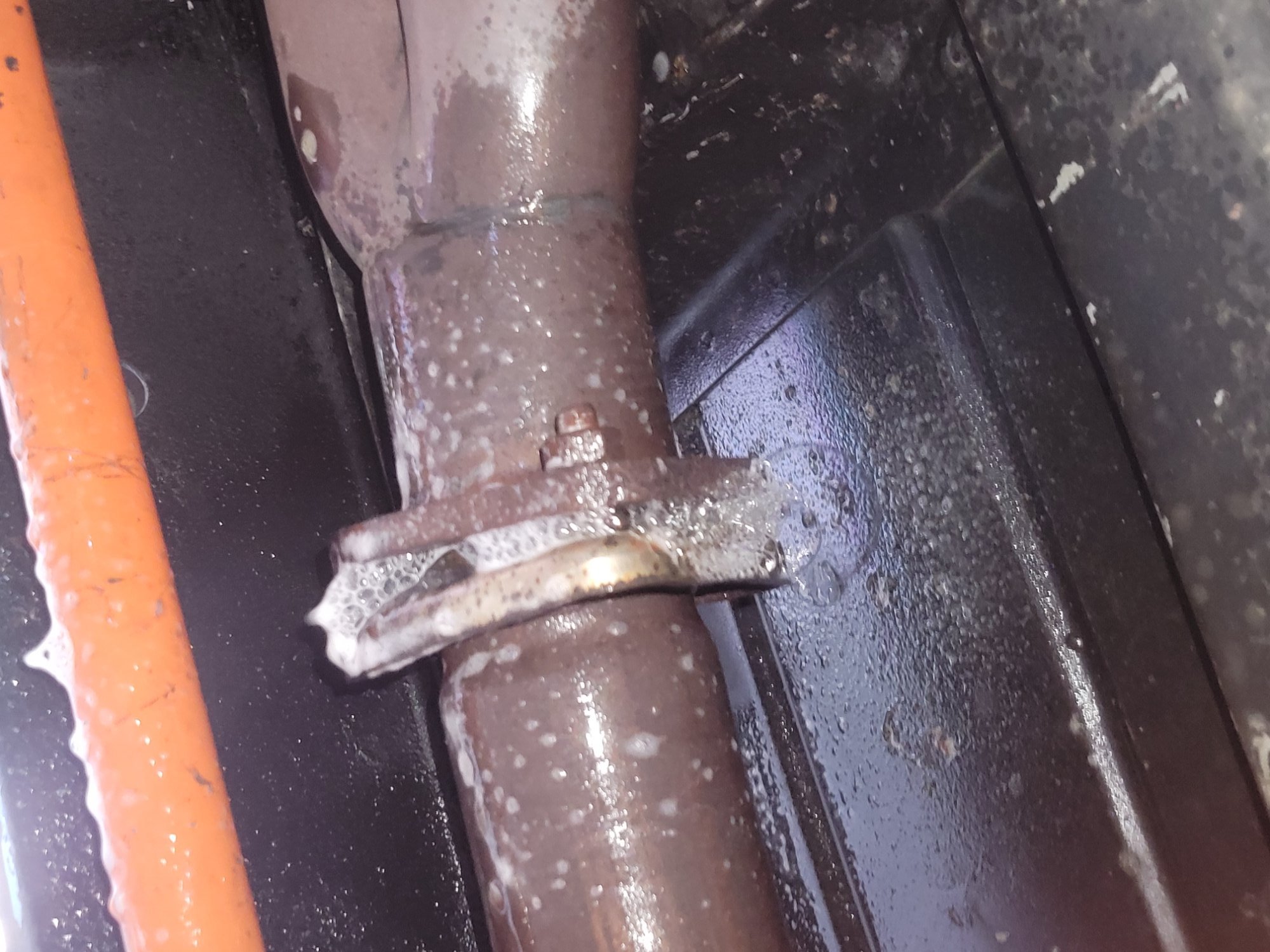

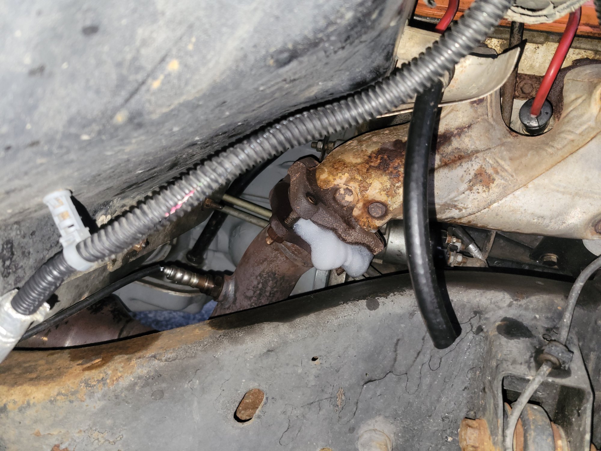

I appreciate y'all helping me out with this I really do. I'ma gonna try to add some pics n video. I'll have to look at the PCM for brand, but definitely looks new . The plugs I bought was ngk and we're already gapped. The ones the guy put in was the same ngks which again makes me wonder why he changed the gap to 32. I did find some significant exaust leaks by hooking up a shop vac and using spray bottle. The exaust manifold is leaking pretty good on passenger side. And the gasket connecting the flange gasket pretty bad leak.

Fix the exhaust leaks first. Your O2 sensors aren't getting an accurate reading of what is happening in the combustion chamber. The PCM is trying to adjust the engine based on the lies the bank 2 O2 sensors are spreading.
The screenshot of bank 2 sensors is telling. Sensor 2 is following sensor 1.

I know you all told me these trucks like certain brands, I'm buying the manifold gaskets today and gonna work on it this weekend, is there a particular brand this old hussy would prefer? She's turning out to be kinda moody so I wanna do it right
Want it right, get OEM.  The gaskets and flange seals aren't that much, and the OE ones are quality stuff.
