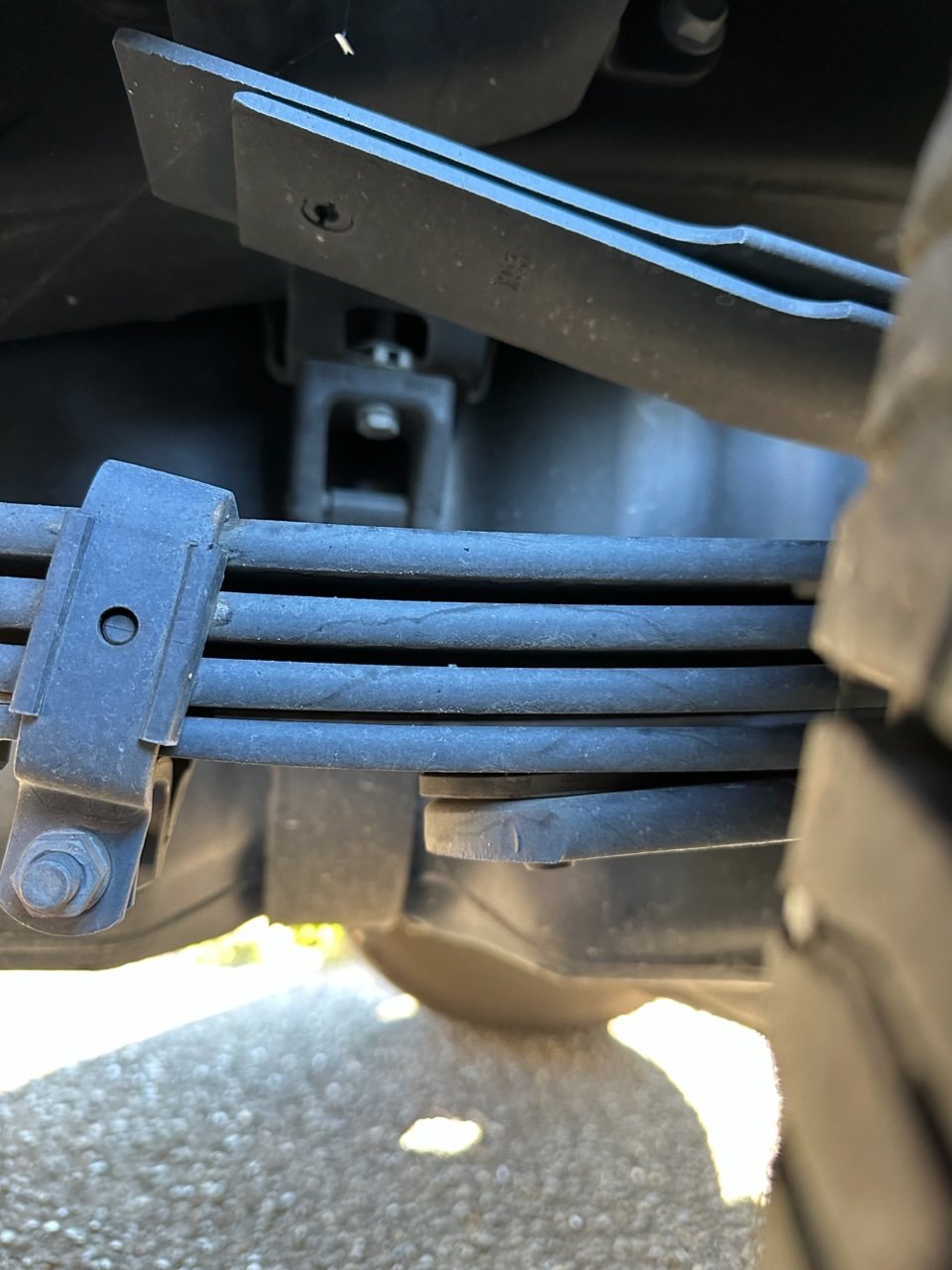

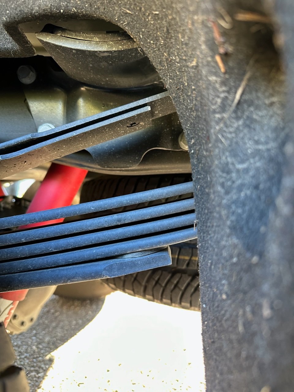

How about we compare pics?  This is from my 2500 a front and rear pic of my spring pack.  Lets see yours if you have the time sir because this topic intrigues me.  Not of your overloads on the topside, just basically the same pic from your 3500 spring pack as mine.

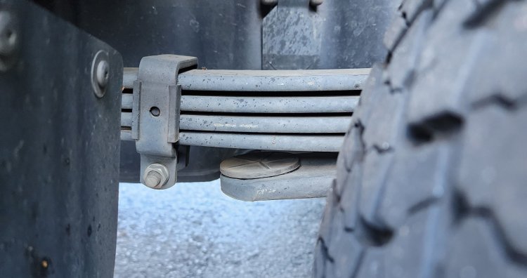

You showed me yours so I guess it’s only fair to show you mine …

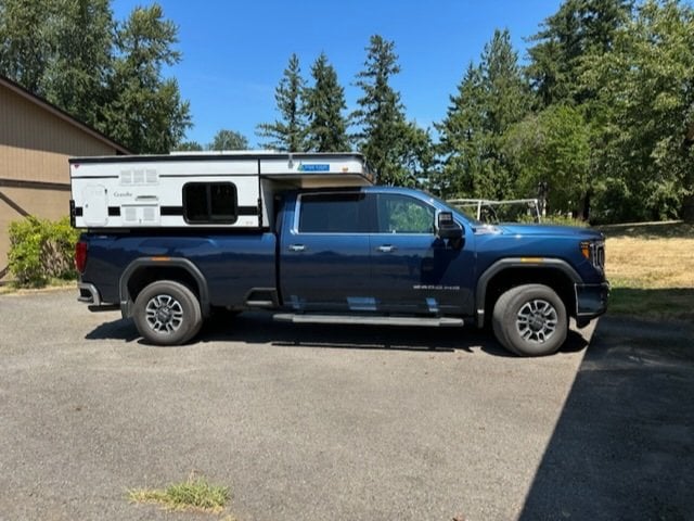

Unfortunately I have my pop up camper in the bed, sitting at 1500 lbs with empty water tanks and no food or gear (I’ve weighed it.)  Nearly all of that weight (1400+) is on the rear axle. As you can see my secondary springs (not the overloads) are in contact at that weight. One of the pictures looks like maybe there’s a gap but the plastic pad is in hard contact. When the truck is empty there is a gap.  My payload rating is 4055 and RGAWR is 7250.   Spring pack part number is 84992006. My overloads are about 1.75 inches from the bumpers with the camper on at this weight.

Would I be wrong saying your main spring pack looks identical to mine sans the overloads?
It’s hard to tell from the picture, but the part number is stencilled in big numbers on the bottom of the spring.  They certainly are very similar.
That's my point.  They are identical.  You have the 2 overload 3500 helpers on top of your spring pack.  But our basic spring packs are identical.  Tell me I'm wrong.
